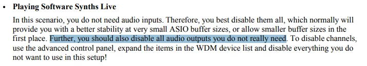

    This is what I'm trying to do, does this also work when making an aggregate playback device from 2 devices, specifically the 3.5 headphones and speakers on laptop?
    I've got close, but when using this ASIO the device I'm getting no sound.
    The log from an ap which detects available devices shows the increased outs (from 2 to 4)
    ASIO : ASIO4ALL v2 (device #10 with 2 ins 4 outs)
    Is it just me ?
    Should I try adjusting Exclusive Audio?

    ASIO guide
    Will leave there as doutbful this post will show as contains images 😞
