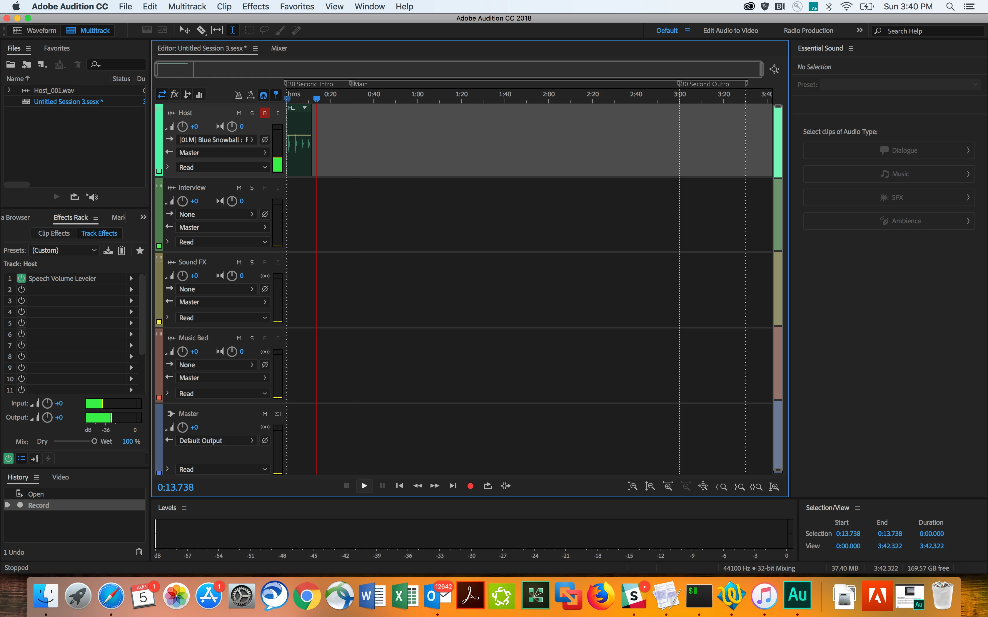

    Can you show us a screen-grab of the multi-track mixer, please?
    Aug 5, 2018 10:53 PM UTC
    I hope you can see enough from these. I have the respective mp3s but I can't seem to find a way to post them.
    Thanks again.

    SteveG_AudioMasters_Community ExpertCorrect answer
    Aug 6, 2018 8:48 AM UTC
    Well... you haven't provided a shot of the mixer, but even so it's pretty clear what's happening. You've got the speech volume leveler on track one as a track effect. Remove that (it has no place being there) and all will be well. What the speech volume leveler does is even out speech levels by altering the gain of the signal, and this inevitably has the effect of modulating the noise. It's worst when you have silence in pauses - it thinks there ought to be speech there and turns it up as far as it will go! If you want decent sound from speech, it's not exactly an ideal way to achieve that; looking at the levels you have after you've recorded them and applying a limiter to the peaks is a much better-sounding approach, as it doesn't alter the overall level.
