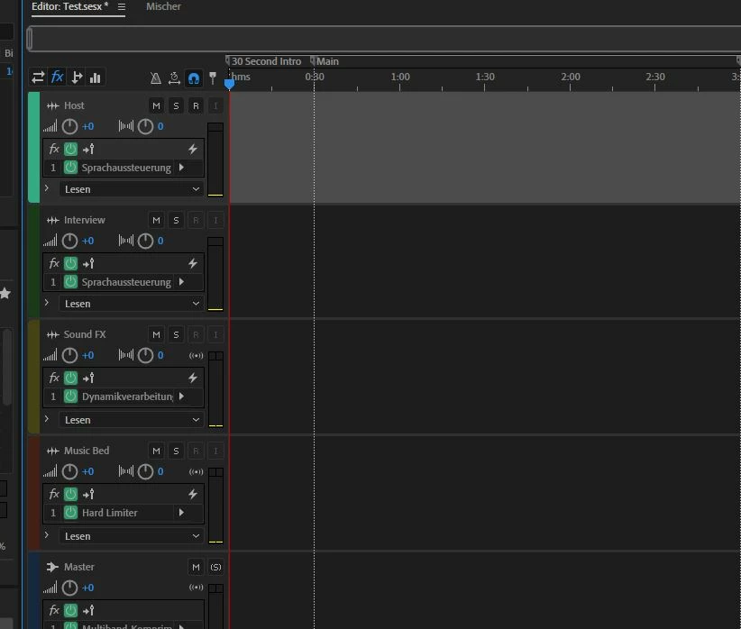

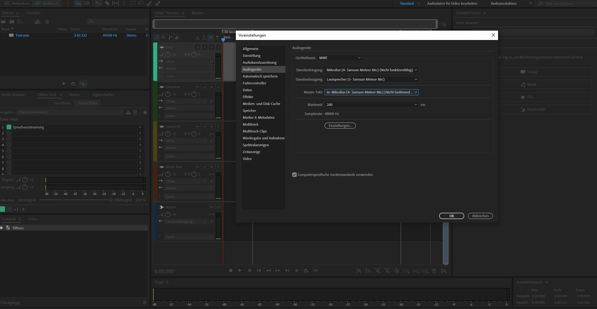

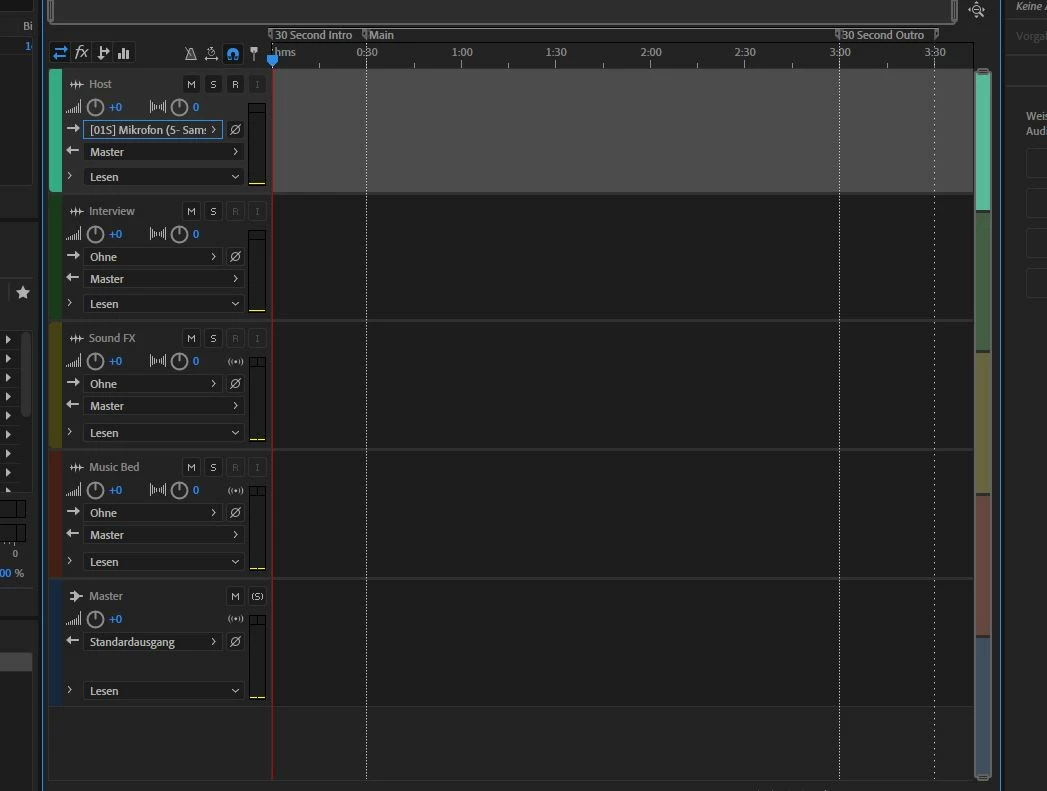

What I did:
I created a new file for a multitrack session and chose "podcast" for the general settings.
Attached are 3 screen-grabs. I hope they show what I did for recording.
There is one thing I also noticed. If I deactivate the power buttons in the multitrack session for the host, the noise sounds reduced.
Thank you!
Corinne
Mar 19, 2021 7:27 PM UTC
"I created a new file for a multitrack session and chose "podcast" for the general settings."
There is pretty widespread agreement amongst posters here that making that "choice" is the very thing you should NOT do!  That particular template has settings, and especially Effects, which are quite possibly the source of the noise problem for you!
