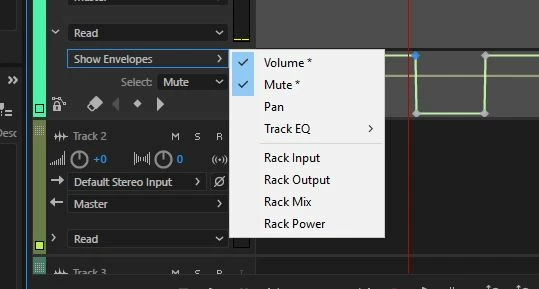

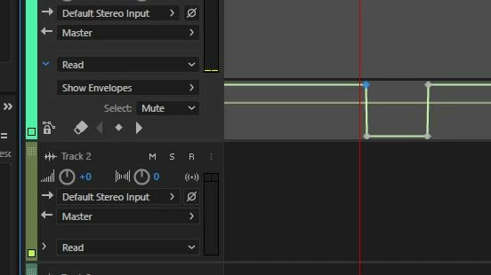

Okay, a couple of screen-grabs:
On the upper track, you can see that I've 'twirled down' the little white arrow next to the 'read' button, and now it says 'show envelopes', with the mute automation selected - this is typically what it looks like when you display the envelope. The actual selection options look like this:
... and you can control pretty much anything here.
If you really don't want any automation, you can set the box that says 'read' to 'off', and none should be applied. If it still occurs, then almost certainly you've got some sort of gremlin in your session file, and I'm beginning to suspect that this might be the case if you haven't actually set this up to happen. If this is so, then you are going to need a bit of help from our resident session file expert - Suite Spot...
