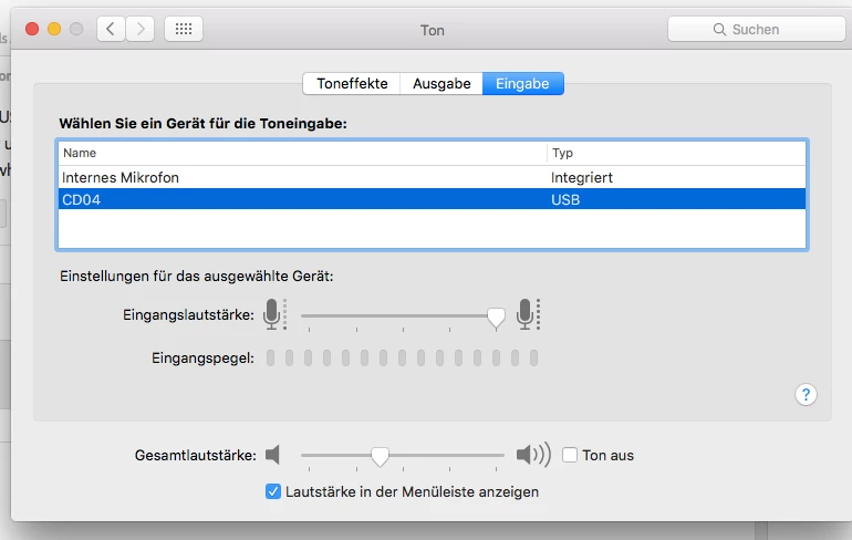

    Ok. It's exactly this model:
    https://www.amazon.de/gp/product/B073ZDMP3R/ref=oh_aui_detailpage_o03_s00?ie=UTF8&psc=1

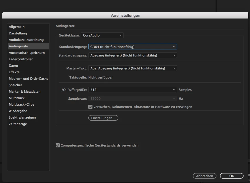

    It's just the usb cable. I have selected the microphone in the settings and it works, but as soon as I select the microphone in audition it says non functional. I have the screenshoted the problem. Watch out it’s in the german, but it gives you a hint.

    Well the problem may be the Sample Rate. According to the info on the mic it is 48kHz so Audition will have to be set the same. Try unticking the two boxes 'Versuchen etc.' and 'Computerspezifische etc.'
    Also the Master Clock is set to Output which is not working. Try changing that to Input CD04. Another problem may be that the mic doesn't have a headphone jack on it like more expensive USB mics so Audition gets confused because it normally expects the Input and Output device to be the same. You will need to make sure that Audition's default Output is set to the Mac's audio out. This may mean messing about with the Core Audio set up on the Mac which I know nothing about being a purely PC user I'm afraid.
