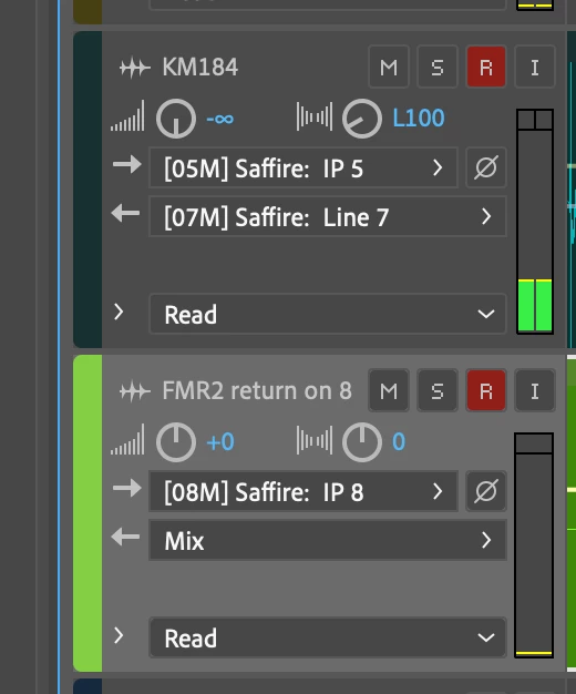

I'm almost embarrassed to ask this question, but I can't seem to find a clear answer anywhere. I need some simple steps to route audio from an Audition analog mono track out to an external effects box and receive it back into a separate track so that I can inject it into my mix.
I am set up in multitrack view with mic inputs (via a Focusrite Saffire D/A interface) going into mono channels 1, 2, 3 and 5. I have an Audition track corresponding to each. I would like to send the signal on channel 5 out to an external (physical, actual) rackmount RNC compressor and route the signal back into my mix. In terms of physical connections, at present I have my Saffire interface sending out to the compressor on its output jack 7 and receiving the treated signal back on input jack 7.
In my (admittedly hazy) understanding, I need to route my Audition track 5 to Saffire channel 7, then add an Audition track to receive from channel 7. The idea would be that inbound channel 7 should contain my compressor-treated return signal. (Do I need to use a bus for this?) Despite considerable fiddling I can't seem to make this basic operation work...I get no signal back on that channel 7 no matter what I do. Dead as a doornail.

I misspoke. I am getting my mic signal in on 5, sending to the compressor on 7, receiving back on 8.
Have you listened directly to the output from the RNC? Alternatively, if you plug anything else into input 8, do you get level from it?

I don't know for sure, but it sounds like you've used too much Saffire channel 7. I'd be looking at something like this:
Audition track 5 to channel 7 output. Feed that signal to the RNC, and feed the RNC output back to a different input on the Saffire - like 6, or whatever. Set Audition to recieve channel 6 and leave the track output set to Master. No you don't need a bus. Also doing it like this should make it fairly easy to check the signals at each point in the routing.
Or I could be completely wrong. Try it anyway?

Thanks, Steve. Just tried that out, sending on channel 5 and receiving back from the compressor on 8. Nice signal from the live mic on 5, as expected, but still dead on 8. Harrumph. Bah humbug. Etc.
I'll attach a screen shot of the mappings I have. If those look right to you, I'm really stumped. In the screen shot, the KM184 track is the live mic signal coming through the Saffire's pre. Nice level there.
Jan 6, 2022 12:58 AM UTC
