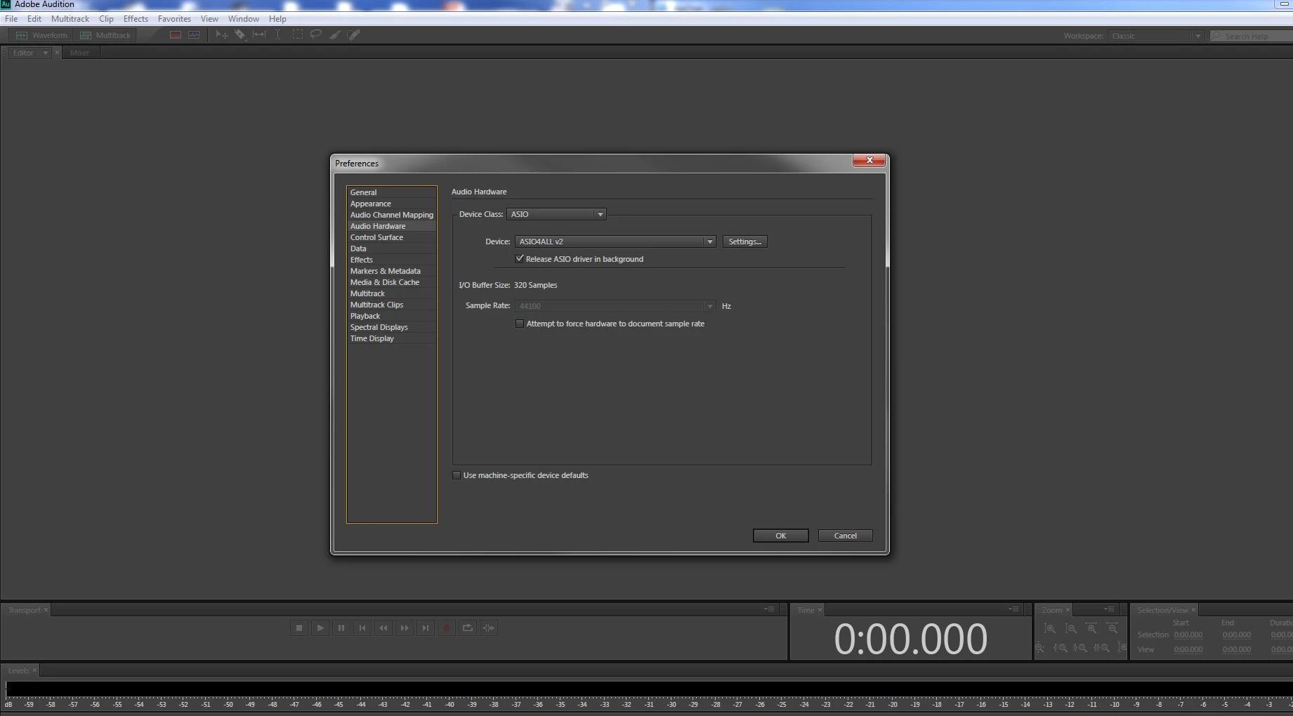

    Does this help?

    What drivers do the other bits of software use?
    The thing about ASIO is that it punches a way straight through the OS, and none of the OS-based volume controls will affect it in the slightest. That is, assuming it's the USB version of the ART preamp you're using. Is this correct?

    Okay I just checked and it looks like Sony Studio is using Microsoft Sound Mapper rather than the ASIO drivers (I hadn't touched it since I switched to using Audition until I used it to try and test/figure out this current problem the other day)

    What driver are you using? ASIO or one of the Windows ones? This is likely to be driver or settings-related; Audition is very good at recording exactly what it's sent, so it's very likely that what is causing this is going to be because you're using a different driver. Given a free choice, Audition always prefers ASIO - the engine's ASIO-based so no conversions are necessary.
    ryclark
    Aug 9, 2018 10:11 AM UTC
    It would help us help you if you could post a screen garb of the Audition Audio Hardware preferences page to see what you have selected for your audio drivers.
