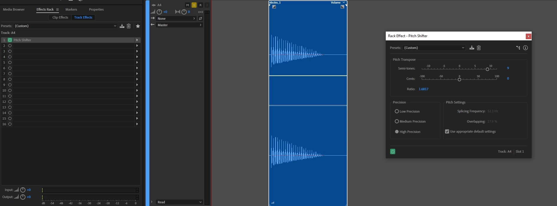

Here's what I'm doing.  I have a lot of little sound effects for a game, and some of them need to go another octave up, so I'm pitch shifting them and they sound great playing back.

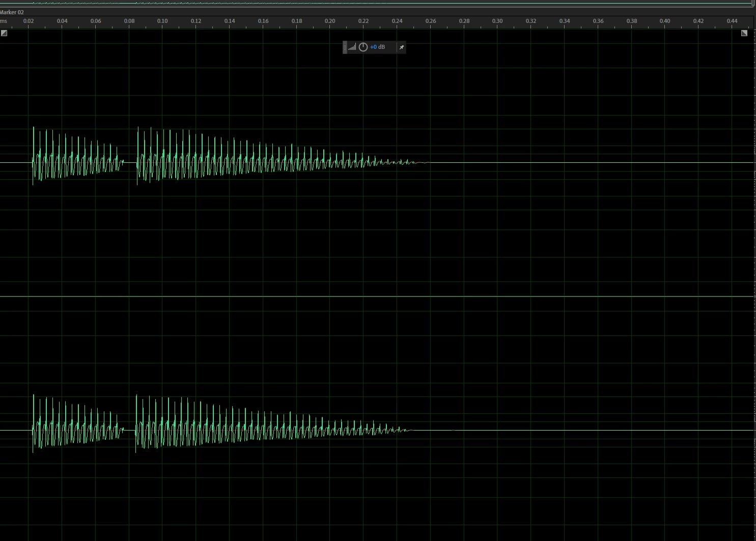

On export (Multitrack Mixdown -> Selected Clips), however, this happens.
(Also on Mixdown Session to New File)
An extra little stutter sneaks in.  I assume this can be traced back to some law of the universe that says raising the pitch requires human sacrifice, but I can not for the life of me resolve it.  Even bringing it back in and trying to cut it out, this stutter persists.

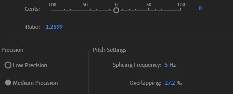

    Ahh, I just figured it out in the middle of replying ^^  It's the Splicing Frequency.  I had read from the documentation "At higher Precision settings, a lower Splicing Frequency may add stutter or echo. If the frequency is too high, sound becomes tinny and voices have a tunnel-like quality."  I doinked around with it to no effect, but never tried putting it super low, which resolves the issue.
    I had tried different bit depths, sample rates, running it through media encoder.  It did feel like some kind of sampling issue because scooting it over a little bit in the timeline affected how much it would stutter.  But there you go, Splicing Frequency.
