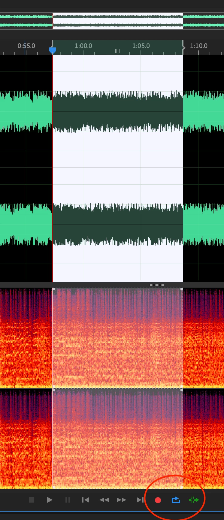

A few basic tips for cutting, stitching, mixing music:
  • In Audition, zoom in to where you can see the peaks and valleys of the wave form.
  • Listen with headphones (or earbuds) while editing. You'll pickup notes and problems much more easily than if you're using speakers--even great speakers.
  • Look and listen for the beat of the piece and remove/cut/stitch so that that beat is maintained. You don't want 1, 2, 3, 4, 1, 4, 1, 2, 3, 4.
  • Select the area of music you think you want to cut out, then turn on Loop Playback and Skip Selection (the blue and green buttons in my screenshot below, respectively). Skip Selection will let you hear a few seconds before your selected area and then immediately a few seconds after, as if the selected part was already deleted. You can then adjust the selection as needed on either end until you hear a smooth transition between the part before and after the selection. Loop Playback just replays that section over and over again while you adjust so that you don't have to keep hitting the Spacebar or the Play button.
    When happy, click Delete (in Waveform editor) or Shift+Delete in Multitrack mode to delete and automatically bring the ends together (Ripple Delete). Keep in mind that you might not want a hard cut--it depends on the music--and may instead want to blend the ends together with a crossfade--in very simple terms, two sound pieces overlap and blend together, which can smooth out cuts.
