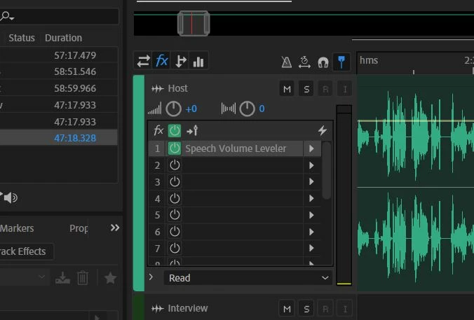

Just wanted to add in my personal solution.
I created a "New Multitrack Session" for "Podcasts", and it must have automatically added the "Effect" called "Speech Volume Leveler". You can find it by going to your multitrack session and clicking on the "fx" icon to the left of your tracks. Hit the green power icon to toggle it on and off so that you can hear the difference.

@parris_ink
What you have discovered is but one of the reasons why the advice here is often stated: Avoid the Podcast template at all costs!!
