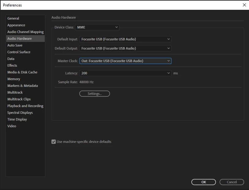

Hello Steve, thanks for answering!
Here's a screengrab of the audio hardware settings

Okay, the hardware settings look fine for an MME device, although if you look in the device class box and select ASIO, you will find another driver - which is the one that Focusrite recommend, after making sure that ASIO4ALL isn't installed on your computer for any reason - see here: Focusrite and ASIO . Whilst it's the correct thing to use, I don't think that on its own it will solve your difficulty. You've clearly managed to make a recording, but for it not to play back at all is a little strange.Your monitoring works fine, because that's routed directly through the interface, and not Audition, so that's a bit of a red herring.
Before we go any further, can I suggest that you work carefully through Focusrite's page on how to set up a 2i2 for use with Audition? Yes, they really do have a page about that... Set up Focusrite for Audition. Please note that this uses ASIO, and it's a good idea to switch to that anyway.
