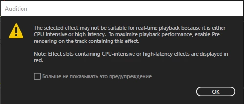

Hello!
Just the other day I started working at adobe audition cc and immediately ran into a problem - I can not adjust the noise reduction. Everything is in the screenshot. It gives an error, Due to lack of experience, it is impossible to solve this problem. I would be very grateful if anyone could help.
    ryclark
    July 9, 2018
    What the popup message says is true. So it depends rather on the power of your computer if it can run lots of effects at once on several tracks. Some type of effects like this and some of the Reverbs may have the same problem. They are not really meant to be used in real time during live recording, but meant for subsequent processing during the editing process.
    You can make the message go away by clicking on the little box on the bottom left and Audition should not then keep reminding you every time you try to use the effect. Hopefully you will find that with a powerful enough computer it will in fact let you do what you want. Try it and see.
