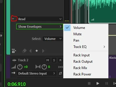

SteveG_AudioMasters_
Dec 6, 2020 10:54 AM UTC
Hit the twirl-down next to the Read envelope and this happens:
I think that what you have to do next is reasonably obvious!

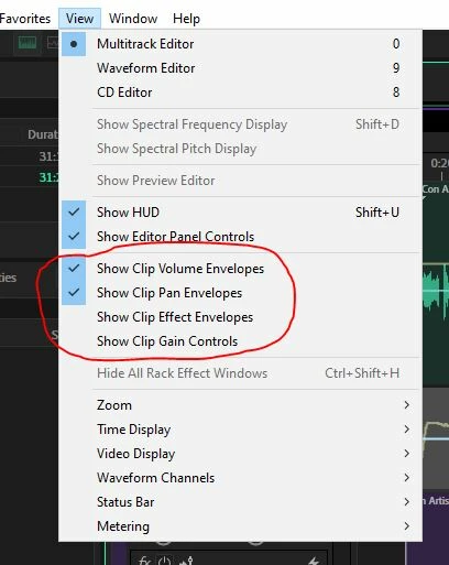

I ran into this issue now in the latest 2021 version. Any guidance on this?
Mar 17, 2021 9:27 PM UTC
The only other thing you might need to do is go to the View menu. Once again, it's obvious what you have to do:
And yes it is working fine in the current release.
