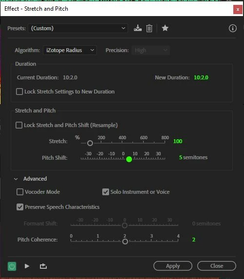

You need Stretch and Pitch, set up a bit like this:
Duration stays the same, but the pitch is raised, in this instance, by 5 semitones. You have to bear in mind that you only want to do this to your voice, not the rest of the track - the pitch shifter will shift everything!

Hi there.
I tried that too.
But when I play it back on the track obviously it sounds wrong.
I think I'll have to record with the track down to -5 pitch, then pitch everything up... not sure.
