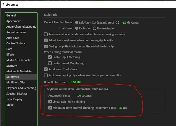

    SteveG_AudioMasters_
    Jul 1, 2019 10:15 PM UTC
    The other thing that could potentially help you is to look critically at the Keyframe Automation settings. Thinning out the data can leave you with perfectly good automation, and rather fewer unnecessary frames. Aside from any other considerations, this will also reduce the size of your session file somewhat!
    EGEmedia
    EGEmediaAuthor
    Jul 1, 2019 10:40 PM UTC
    I don't think that's the cause of my problem but will have a look at those settings as automation does generate an excessive number of keyframes. Thanks for responding.
