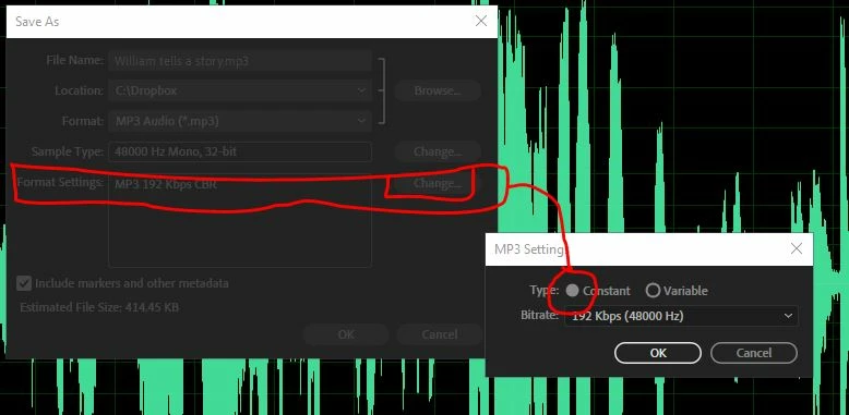

Apr 23, 2020 11:49 AM UTC
There is nothing odd about it at all - it's normal with MP3 files. Here is where you change it:
