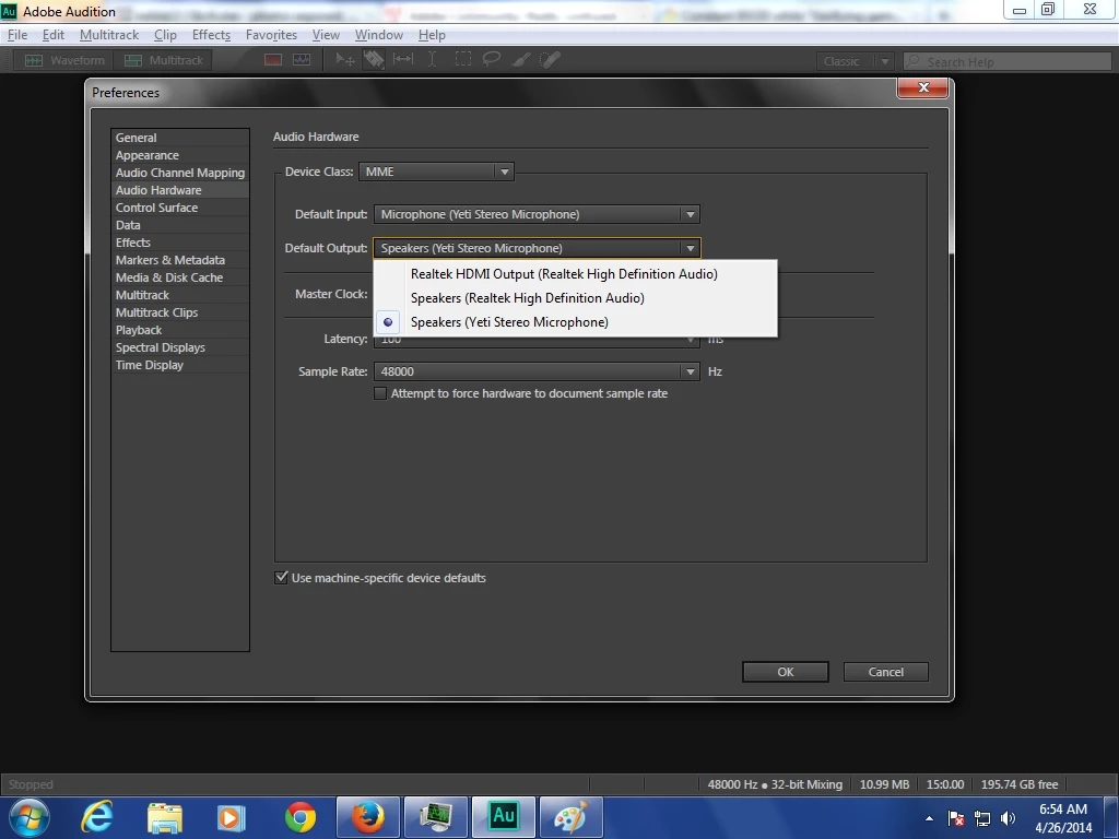

Apr 26, 2014 10:49 AM UTC
Only have a USB mic. no other hardware ( i know not ideal but its a start)
Thanks for what you have said so far everyone, im still lost however. I got to this point.
Multitrack - Loaded the music on track 1, and was unsure whether to arm record on the same track or on track 2, im assuming track 2. Anyways tried both. Armed both for recording and the same problem, it let me record but I couldn't hear my music because the output is "blue yeti" so I switched the output to my headphones and once again I couldn't record.. Heres some screen shots I must be a real noob which I am so thanks for the help.
When headphones become the output

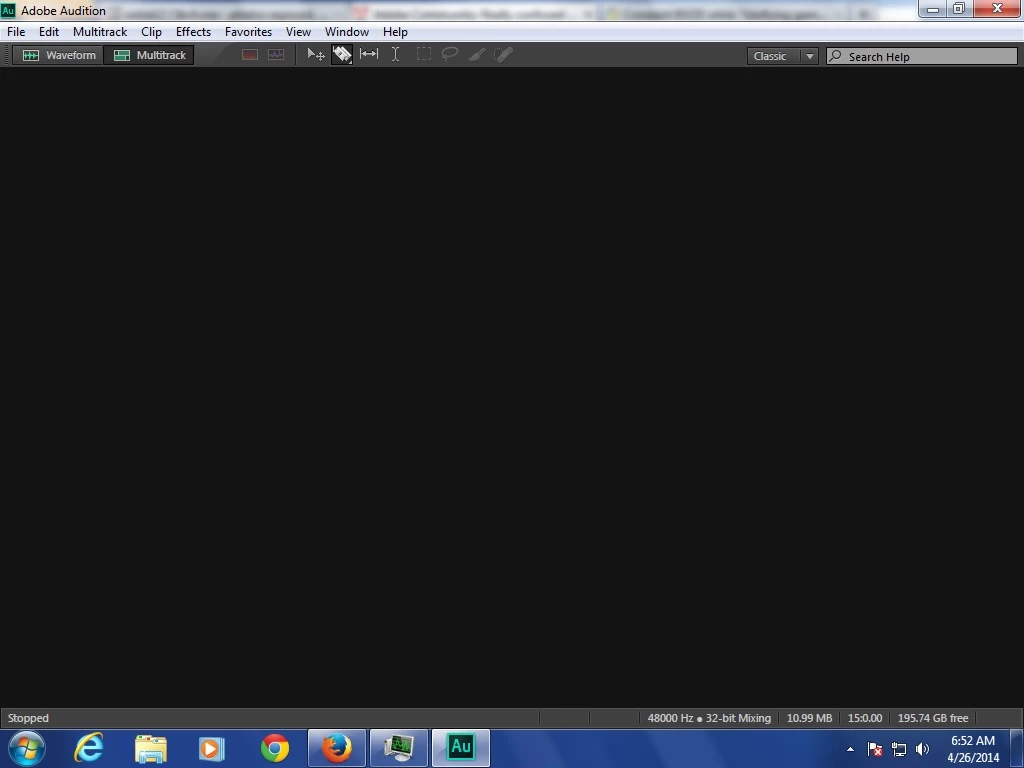

BillferAuthor
Apr 26, 2014 10:55 AM UTC
edit: sigh.. I guess print screen doesn't post to the site, so I went back and tried to recreate the screenshots and now everything is just dissapeared.. I dont even know what is going on lol. Everything just dissapeared..
for what its worth heres the setup
Apr 26, 2014 11:03 AM UTC
Cool, a few things.
You only arm the track you want to record on. So don't arm track 1. Arm track 2. But before that check if track 2 is a mono or a stereo track. Make sure the track you are recording on (track 2) is a mono audio track. then hit record  (shift + space) and sing

Apr 26, 2014 8:58 AM UTC
What's your setup? Do you record straight to the computer or you have a converter / mixer in between? Also I'd request you to go to Edit > preferences > Audio hardware and take a screenshot of the audio in and out dropdowns and paste it in your reply.
