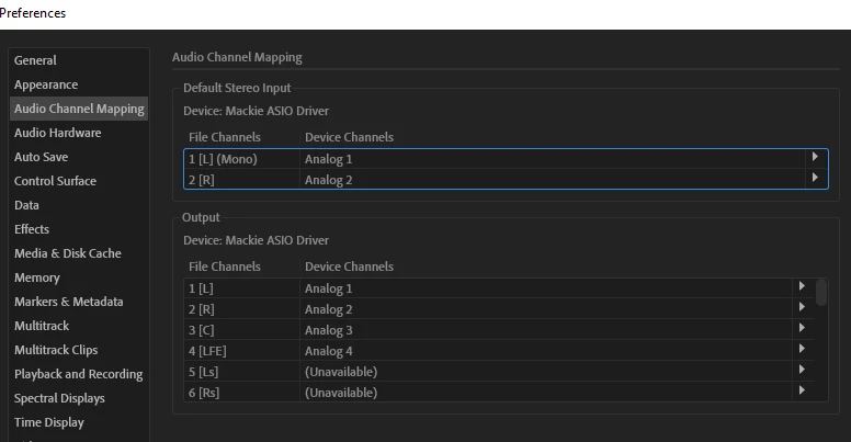

In Audition I setup the audio hardware as Device Class: ASIO and Device: Mackie ASIO Driver. Under Audio Channel Mapping (also see attached picture) I have L1 as Analog 1 and R2 as Analog 2. For testing purposes I created a multitrack session and set Track 1 as L1 and Track 2 as R2 as mono inputs. I'm not getting any waveforms or indication that audio is coming in when recording a test track with the microphone. As another test I switched to MME to see if the analog mic input to the sound card was working and it does record and playback.

You could only do that if you could get the Skype output into the mixer somehow, but you won't be able to do that via the USB outputs, because they are only available to Audition via ASIO, which cuts out any input from the computer itself. If you could persuade the Skype output to feed to the external headphone output and feed that into the mixer directly as an audio input, then it might work.

Yes, the mic works in Skype, because Skype isn't using the ASIO driver you need to run the mixer - so it can still use something plugged into the mic input on the computer. But there's no way you can record this on Audition - that input simply isn't available, whatever you do, and I don't think that even Virtual Audio Cable would let you do that, as ASIO is protected from the OS. What you have to figure out is how to feed the mic input to skype from the mixer, and then separate out the feeds, bearing in mind that you can only record from the main buses on the mixer via usb - no other options are available on that mixer, which I have to say isn't exactly ideal for this purpose. What would be much better is a mixer that let you record each channel separately, with an option to pick off a bus signal if needed - far more flexible.
Jun 19, 2020 5:22 PM UTC
Thank you for the hints. Even taking Skype out of the picture I'm not able to record directly into Audition unless I'm using MME. I was hoping that any USB mixer would be able to pipe the Main Out through the USB cable so any DAW would get all the channels coming from the mixer in real time either separately or as a single track. It looks like I'll be taking a handheld recorder and plugging into the Main Out lines to capture the audio and then doing any processing in Audition. Since I've only got 2 channels to deal with that should be workable. I've seen many YouTube videos on adding an external recorder.
