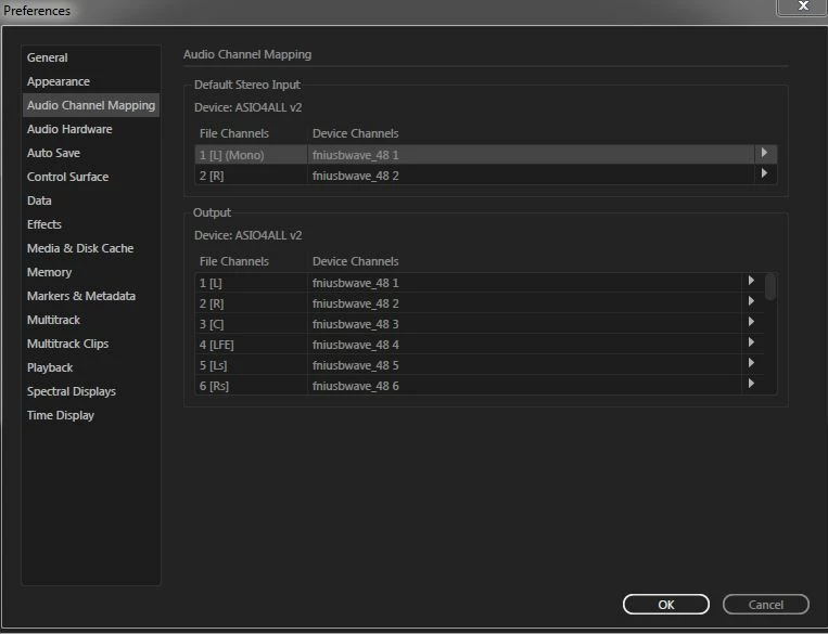

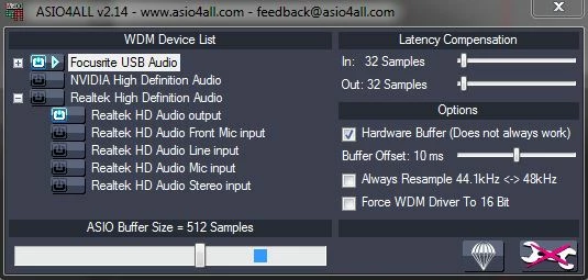

Now I remember, from a couple of years back, when I was still using Cubase 4 LE that with ASIO4ALL there were work around for this issue. Hence I installed the driver again to split the input for the different audio track among devices as I used to. When I select ASIO4ALL in Audition I get nonsensical input channels to select however (at least I can't make sense of them). I added a screen capture below as well as the settings for the ASIO4ALL.
If I remember correctly I was able to select the stereo-mix and mic input separately at that point in Cubase. How do I do the trick in Audition to be able to make this virtual setup work? I would be very appreciative of a reply. Thanks!

You should possibly be looking in each individual Track's Input selection in the Multitrack view. There hopefully you may be able to see all the possible inputs available in Audition. You need to select a Mono source for each track and the appropriate input from the list that appears.
In your picture you may also be able to see them if you click on the right arrow head icons. A dropdown menu should appear with all the available recording inputs to select from.

Hey, thanks for the answer. Sadly I can't select anything but those weird nonsensical inputs in the multitrack view when I have set the ASIO4ALL drivers in the Hardware Setup.

So on the Default Stereo Input part of the screen how many other options do you get when you click on the right pointing arrow head icon? Are there any more apart from the fniusbwave_48 1 and 2? Anything that is not actually ASIO does have Windows limitations, even ASIO4All, which just acts as a translator from the normal Windows drivers into ASIO like streams.
So without using ASIO4All you can select in Audition's Audio Hardware set up window either the Realtek MME drivers or the Focusrite ASIO ones separately?
Life is so much easier with a USB audio interface that provides internal digital routing/mixing like the old M-Audio 2496 that I used to use or my present ESI U24 or Motu Microbook. They all come with built in routing.
Another alternative is to use a Virtual Audio Cable app to do the routing for you.
