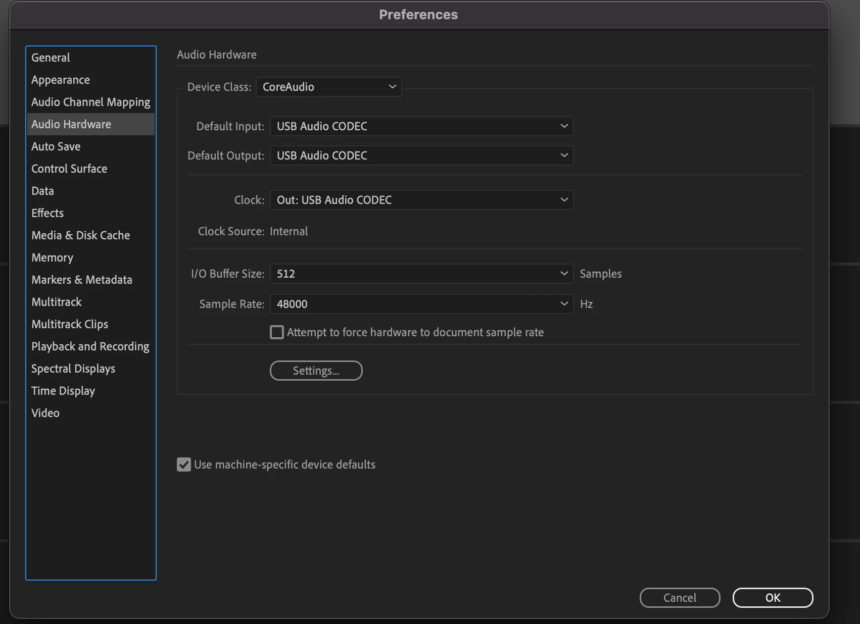

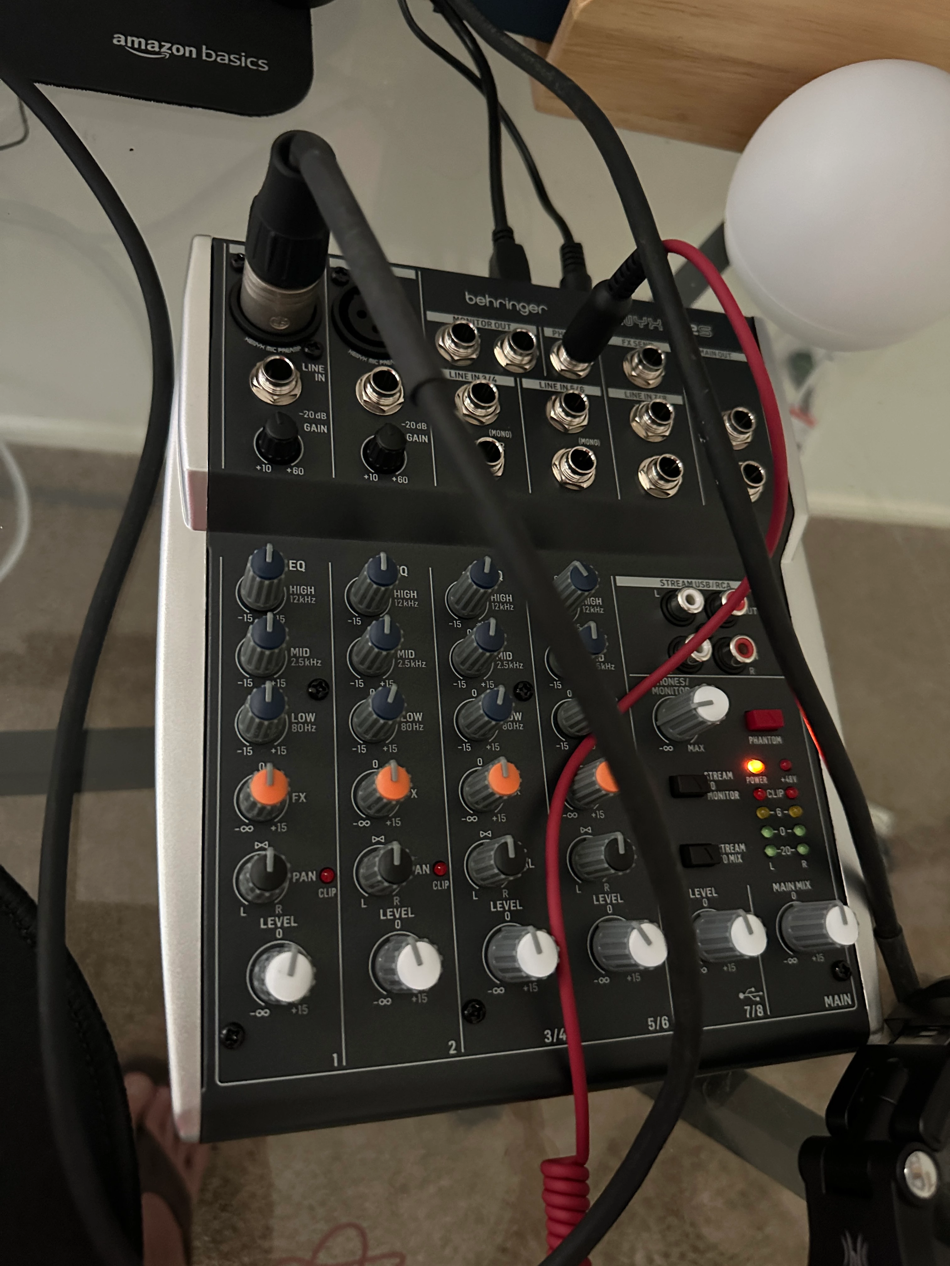

At a minimum, we'd need to see some screenshots of how you've got this set up. Audition is perfectly capable of recording in the way you want, but you do have to set it up correctly, and I'm afraid that your mixer isn't exactly going to help, as it's rather basic for this sort of operation. If you can get the mixer set up so that you can get an instrument into one of the stereo channels and a vocal into the other (you'll have to use the pan pots) you should be able to feed it as stereo into Audition, and by careful channel selection, record each half of the stereo across two tracks, (one channel each). Because of the limitations of the mixer, you won't be able to monitor anything from Audition whilst recording - the only monitoring you will be able to achieve is in the mixer itself.

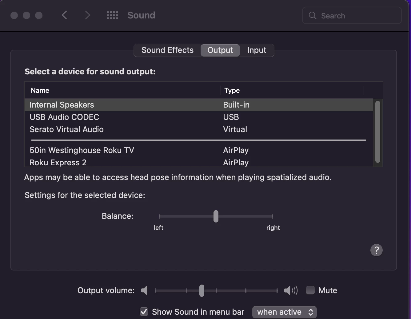

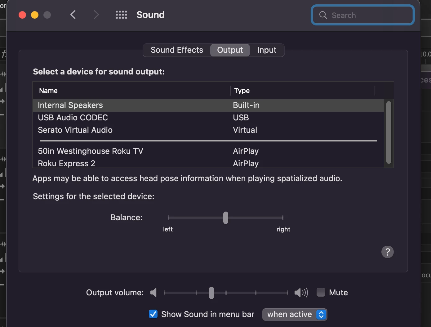

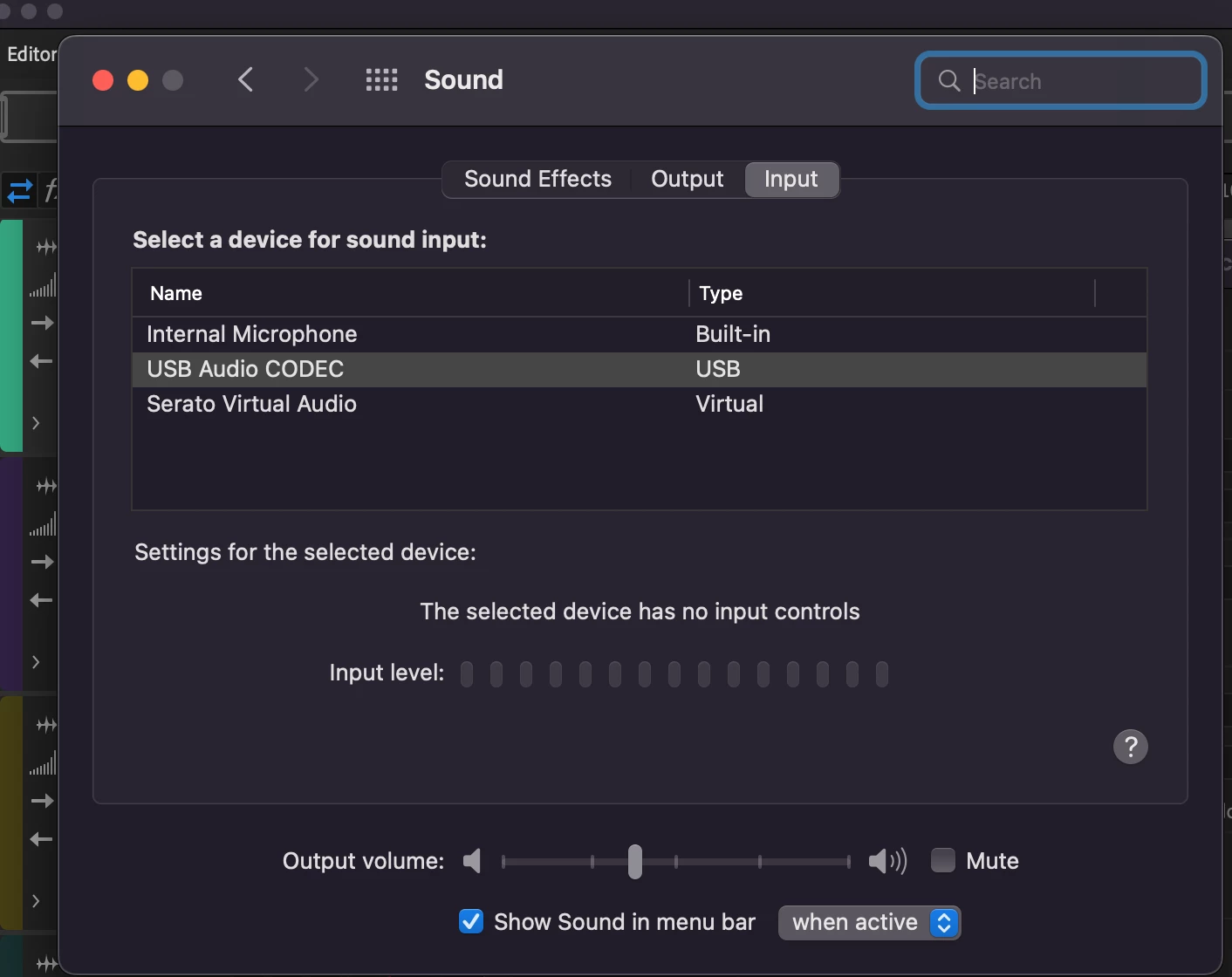

Here are some screenshots, and I've tried all of the options, I suppose mixers are becoming irrelavent and we need 8 usb ports on comuters now. Whats the point if you can run a mic and external speakers and headphones all from one anoalog source. If you could tell me how to set this and what to do if its possible to not have to set the pan on every track, which might be unavoidable. I'm just not used to this software being so difficult but it has been 5 or 6 years since my last album and I'm solo now, my audio engineerer passed away couple years ago. I appreciate any help.
