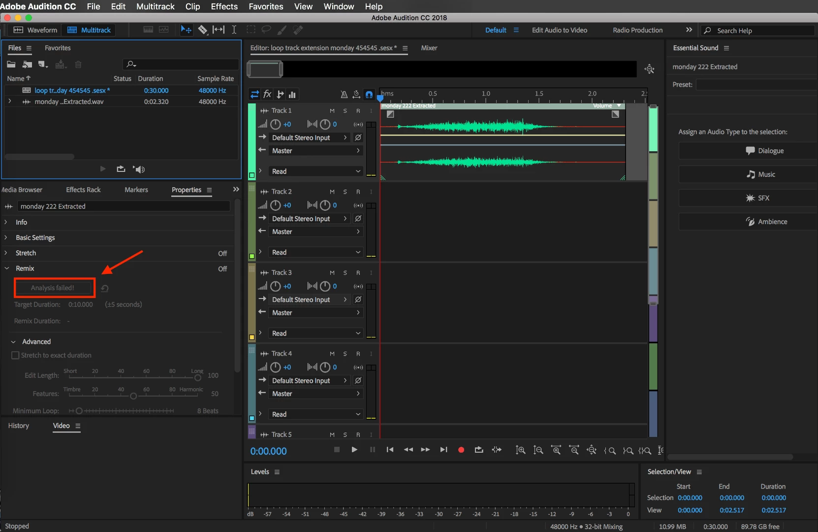

Hi all,
In Adobe Audition is have this audio clip I want to remix (so I can extend its duration), only it's not working. Constantly when I press the "Remix" button it says "Analysis failed". I tried to remix just a normal song I had and this worked fine. It seems like all the time when I want to remix this small 2 seconds clip it's not able to remix it.
The screenshot attached shows the Analysis failed.
How can I solve this so I can extend my audio clip?
Mike.

I think you've reached well below the time range that Remix is prepared to attempt to analyse...

As Steve says an audio clip must have sufficient content to allow the Remix feature to analyse and do the remix. It requires complete audio musical phrases to repeat or cut in order to do it's extend/reduce function. It is not an audio sample editor that might be found in some MIDI sequencing software.

that seems fair. thank you for your help!
