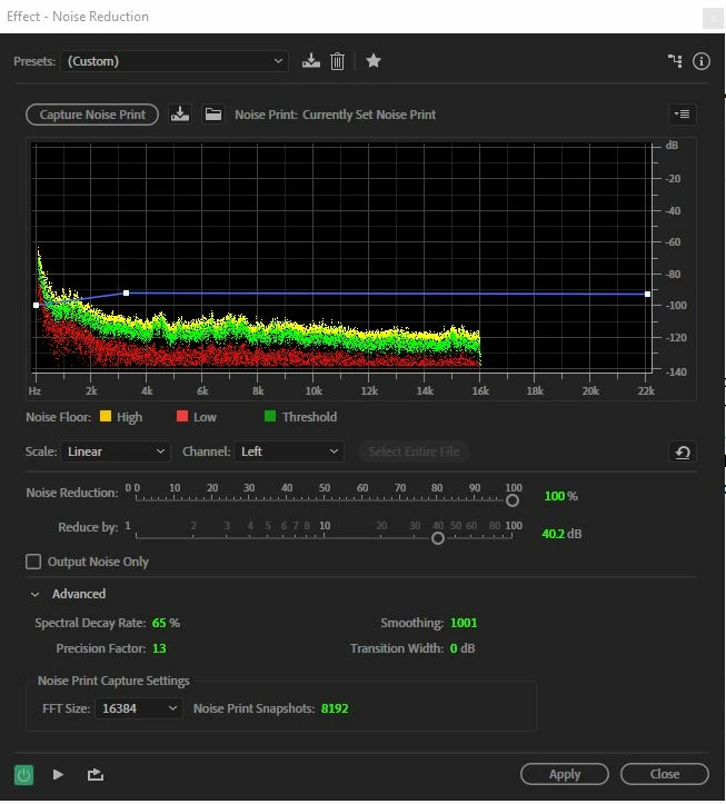

    Because it's a single voice talking, you can reduce that background noise quite considerably in a single pass, without any serious effect on the speech quality, by using what most would regard as quite excessive settings on the Noise Reduction process. Normally we'd suggest using NR in multiple passes and much smaller amounts of reduction at each one, simply to reduce artifacts, but when the noise is pretty quiet in the first place, there's less need for this. The other thing to note about doing this at all is that it's quite disconcerting to remove all the noise - people don't like the sound of that at all, and prefer what would be there naturally in a presentation.
    Anyway, I got a pretty reasonable result by first setting the FFT size to its highest value (16384), then using the initial silent section as a noise print, and the following settings: (the order of operations is significant; if you don't set the FFT size first you'll have to start over!)
    This got rid of most of what was in the background. It's important to note that this approach only works on continuous sound. Fortunately that's what you've got...

    Actually, compared to some of the test sessions we get, this is actually reasonably quiet!
