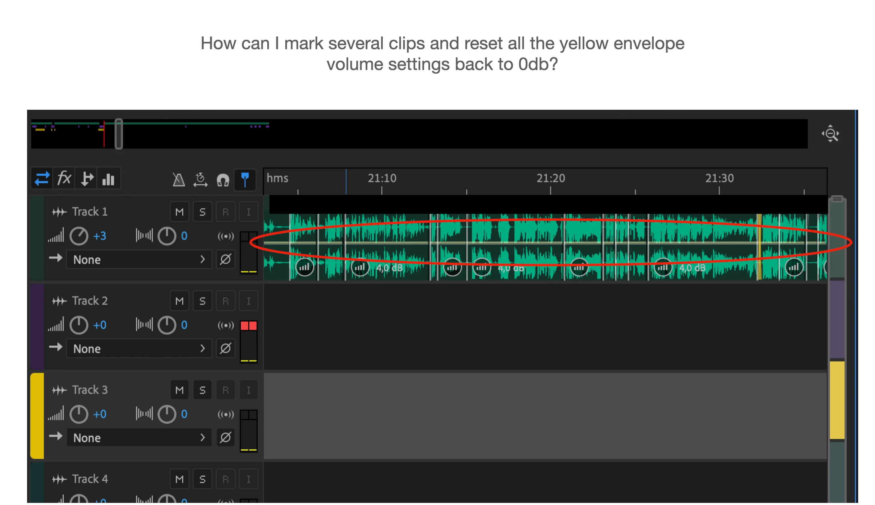

Hi!
I have a lot of clips in a project timeline with changed envelope volume. I haven't used keyframes but just dragged the yellow envelope volume line up and down to affect the entire clip. Now I want to reset all these envelope volume changes back to zero db without having to manually drag each and every volume line to 0 db.
Can I do this in sort of the same way as I can mark alle keyframes and delete all keyframes at once?
Thanks in advance.

Yes they are the same - just in a different place. Select any keyframe and right-click on it. Take the 'Select all Keyframes' option, and then do it again and select 'Delete all Keyframes'. For that track, you're done.
Feb 1, 2023 12:06 PM UTC
Hi Steve. Thanks for the reply but this doesn't solve my issue as I have just lowered the overall volume of the clip using Envelopes. But not added any keyframes. So I want to be able to select multiple clips and somehow "Reset all Envelope Volume settings to 0db". Best - Morten.

Ah. Just dragging the volume envelope line down represents a bit of an anomaly in terms of keyframes - along with the Pan control, which has the same issue. The information about these settings is certainly written into the clip properties, but there's no way of resetting them externally, or by right-clicking on them, which is a little unfortunate. By and large, I think that people tend to leave them alone, and either put keyframe markers down, or use the track volume and pan controls. There are rather a lot of ways of varying the level of a clip, one way or another, and anything not easily resettable except by dragging it might well be best avoided...
In some ways it might not be too difficult to write an app that would locate the data controlling this in your session file, and provide a means to reset it (with the emphasis on might) - but you'd have to ask SuiteSpot about that - it's his field of expertise. As for the devs adding an option to do this, especially on multiple clips... hmm, bit of an ask, that. Generally they freak out about loss of data (look at the overdub scenario) so if they were to provide this at all, they'd almost want to put an 'are you sure?' warning on it before you could action it, I think.
