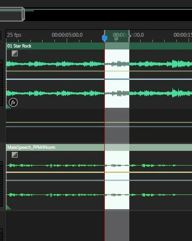

You have to use the Time selection tool to select the time of the gap that you want to delete. Then Time Selection in Selected Clips should be available in Ripple Delete.

If I understand it correctly you need to use Ripple Delete/Time Selection in Selected Clips rather than in Selected Track.

I cannot produce a scenario in which Time Selection in Selected Clips is not grayed out. I am trying to delete the gap between two tracks one of which is grouped to other tracks and i want them to move together when I delete the gap.
When I click on the gap between tracks, only Gap is available under Ripple Delete. If I select a clip i want to delete whose gap I want to instantly remove and let the tracks move left to cover it, then Selected Clips is now not grayed but that deletes the clip and still only a single track moves. This is even if I select all the grouped clips.
