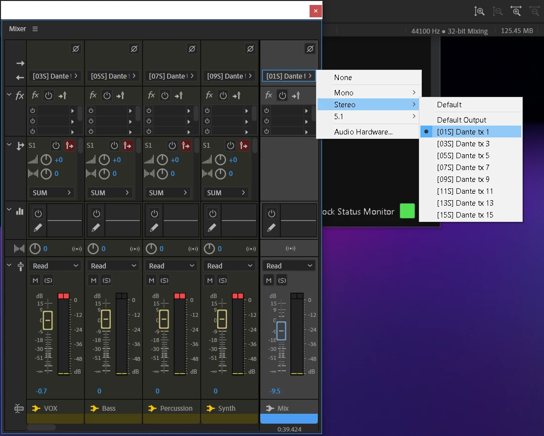

I'm using Audition on a Win 10 machine running Audinate Dante VIA.  For some reason I can only route the Mix bus to a Dante output.  I have VIA set up as 16x16 and CAN route the mix bus to any of the DANTE outputs available but if I route the output of a bus to a Dante TX it does not transmit.

Maybe I'm doing it wrong.  Here's what I want to do...
I want all my channels going to the main mix which I want to see on DANTE TX 1&2
I also want the individual channels to go to DANTE 3&4, 5&6, 7&8 etc.
When I route as shown, I only get output on TX 1&2
I can move the MAIN mix to other DANTE channels and it works, but running a channel strip directly to DANTE using a send doesn't work....

The above post looks to be AI generated, and like the last one, it doesn't address the actual issue that the OP has - this is always a bit of a giveaway. I noticed that you have all the channel outputs routed to Dante. If you do that, then none of them are going to be fed to the Mix output anyway - is this what you intended? In theory you should be able to use the track Sends to route to individual hardware outputs, and simply leave the track output routed to Mix, but for some reason here I can't get the track sends to route to a bus and actually work - which makes me a little suspicious...
