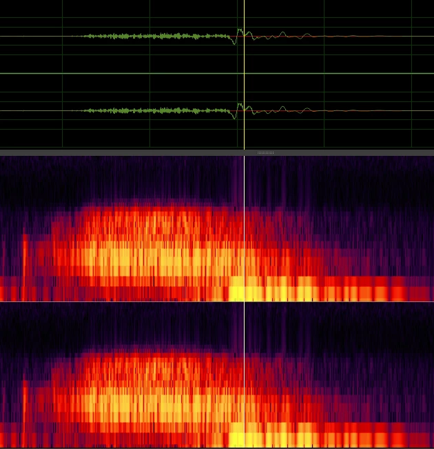

The quality of this mic, itself, sounds fine. But those "puffs" ARE plosives. Plosives don't happen only with the letter "P;" a plosive occurs anytime there is a direct blast of breath (or air) into the mic. This person just happened to have the mic far too close to his mouth, and this is the result. Some of them may be fixable, and some may be only reduceable... by locating each one the Spectral Frequency display (they are low frequency noises, so they will appear as bright yellow blotches – see the screenshot)
, highlighting each one separately using the marquee selection tool and reducing the gain until they sound OK to you. But it will require addressing each one separately because they are all different.

If you can't get a re-record, then the other way you can easily and effectively reduce plosives is to use the marquee tool, as already mentioned, but instead of playing with the volume, use the Favorite 'Auto Heal'. This generally does a good job on plosives (I tried it on some of yours, and it clears them up a lot), and more importantly, you can assign a short-cut key to it, making it much easier and faster to use.
