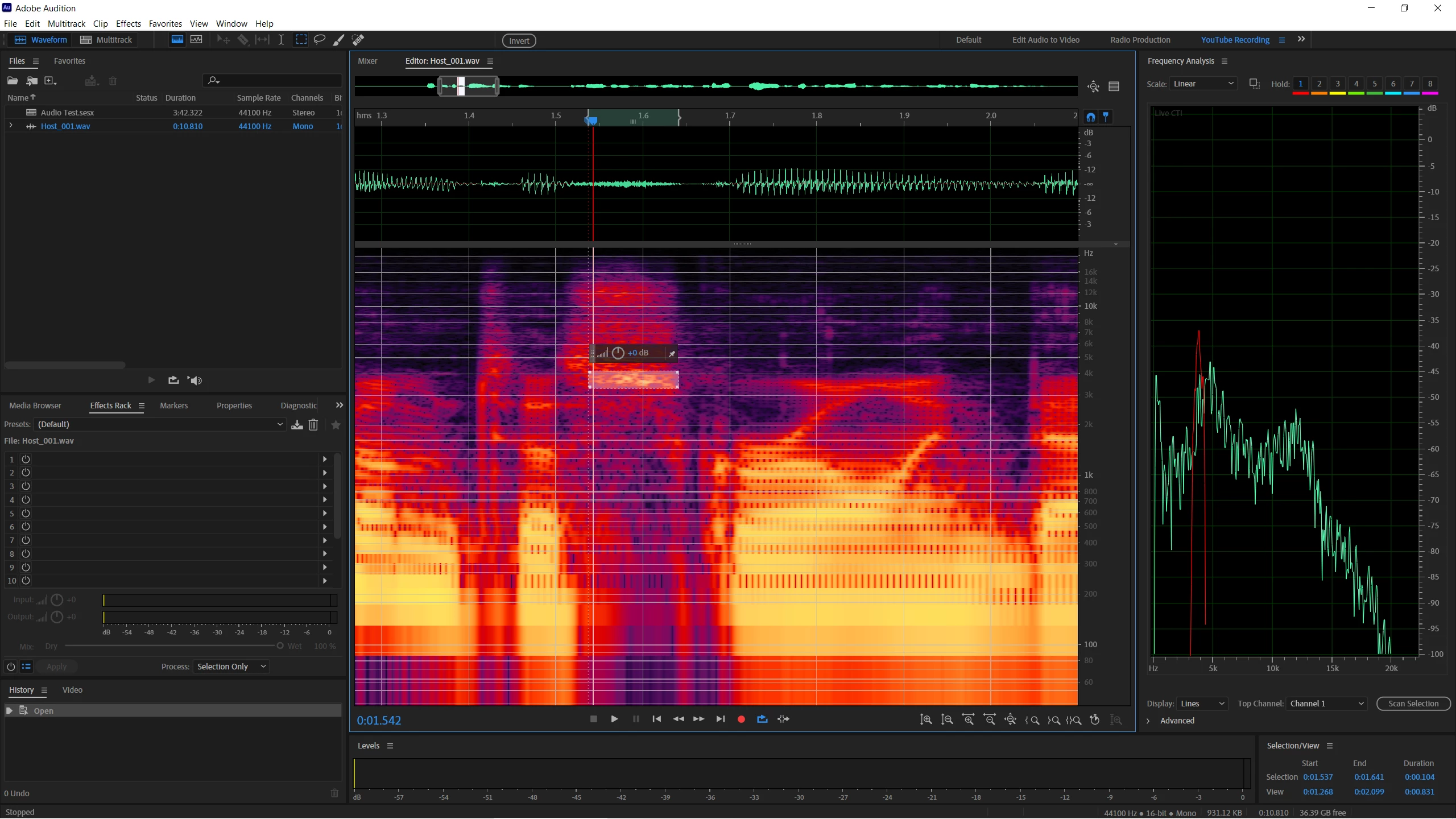

My first step was identifying an "S" sound using the Waveform and Spectral Frequency. The very first example is when I say the "S" in "Scrolling Down the Belt", very close to the beginning. I isolated the "S" sound using Spectral Frequency and the Marquee Selector Tool to where I could hear only it. And if I understood the video correctly, I was really looking for parts that showed up as orange on the heat map. While it maybe wasn't as obvious to me as it was on the example in the video, I think I managed to locate such a spot:
With that identified, I opened up Frequency Analysis, looped the clip, did a hold, and got what you also see in the screenshot above. If I hover over the highest red peak there, I get a value of around 3747 Hz.

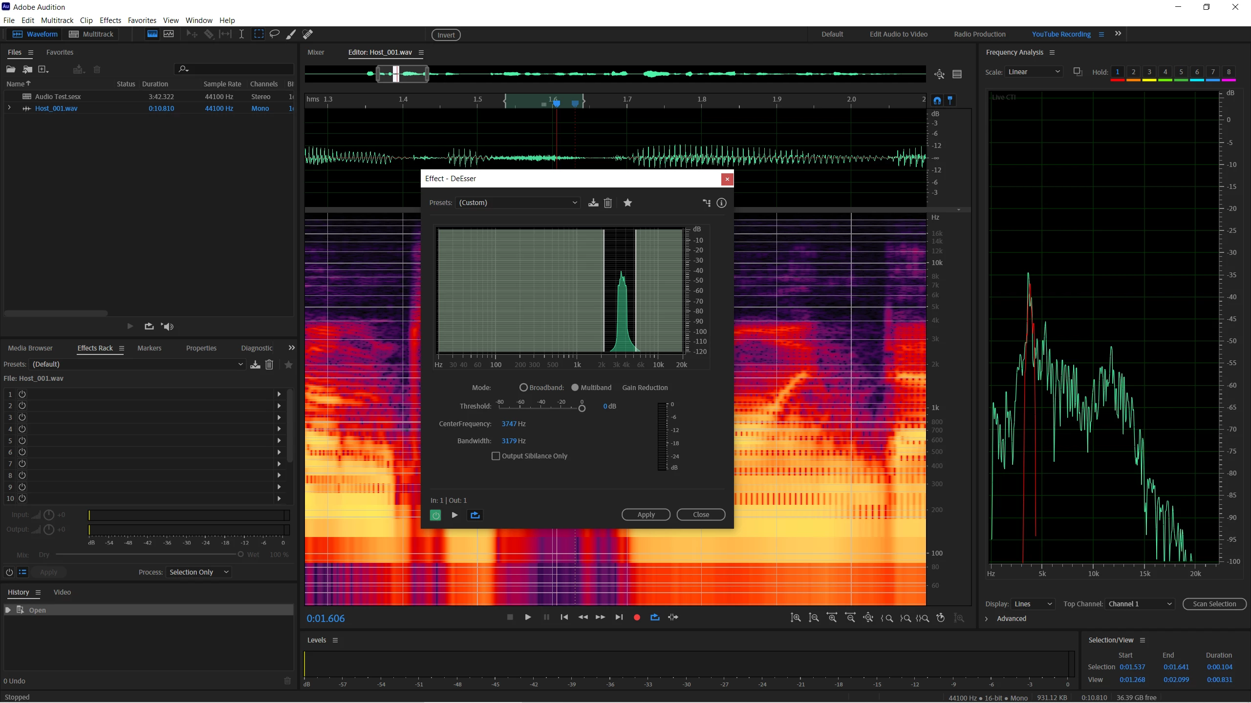

With this, I opened up DeEsser and entered 3747 as my CenterFrequency, with a default value of 3179 Hz as my Bandwidth. Given that the spike in the last screenshot was somewhere between -35 and -40 dB, and I seemed to have a similar spike within my range on the waveform in the DeEsser, I figured I had the range about right. This is what my waveform looked like in DeEsser with just the highlighted clip playing:
From here, with the "S" clip still selected, I slide the Threshold from 0 dB downward until my Gain Reduction finally started having a significant value appear on it. It took me until about -33.4 dB before I got even a single line appearing on the Gain Reduction. -35.3 dB got me two lines, -37.6 dB got me three lines, etc.
So I decided to start with the value of -37.6 dB. I then de-selected my highlighted "S" clip and listened to the entire thing with the DeEsser turned on. From here is where I question my own sanity/expectations because...it seems either to be doing basically nothing different, or the Gain Reduction is firing all the time. And according to everything I've seen, you do NOT want the Gain Reduction firing all the time. So I'm at a bit of a loss at this point, and I would love for someone to tell me what they feel like a reasonable level is for this particular example and how they came to that decision if possible...just because at this point I feel like I'm never really going to land on it.
