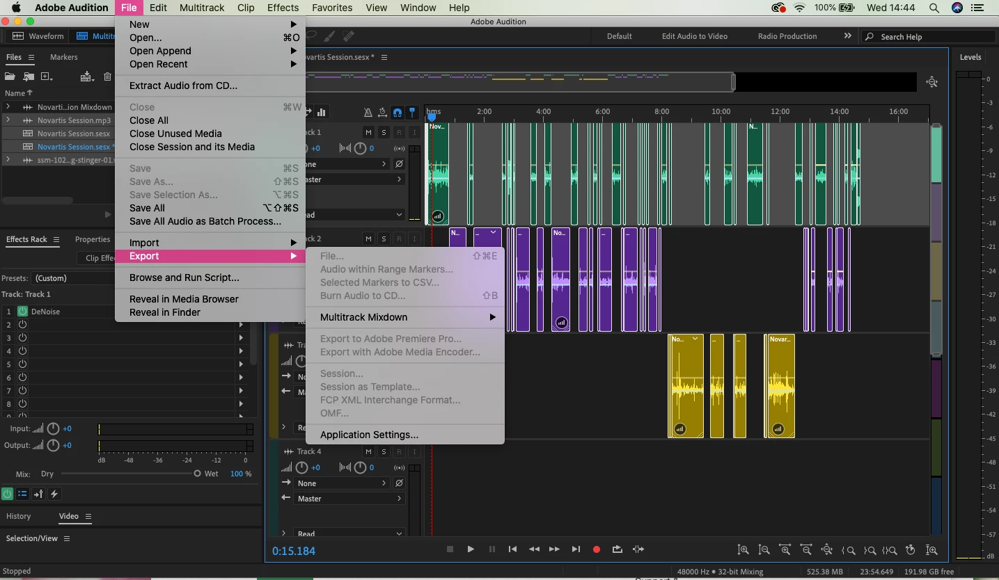

Hi guys,
For some reason, I cannot save or export my multitrack session, all options are greyed out. I can, however, go to Multitrack> Mixdown session to new file to export it, but I obviously would like to save my sesx file. My tracks are all set to master.
When I was editing, my audio hardware preferences were set to my headphones, which I have since disconnected and set back to my laptops hardware for both output and input - I'm wondering has this anything to do with it? Ive set it back and connected my headphones again, but still no joy. I'm also running 13.0.4 software.
Any help would be appreciated, thanks!

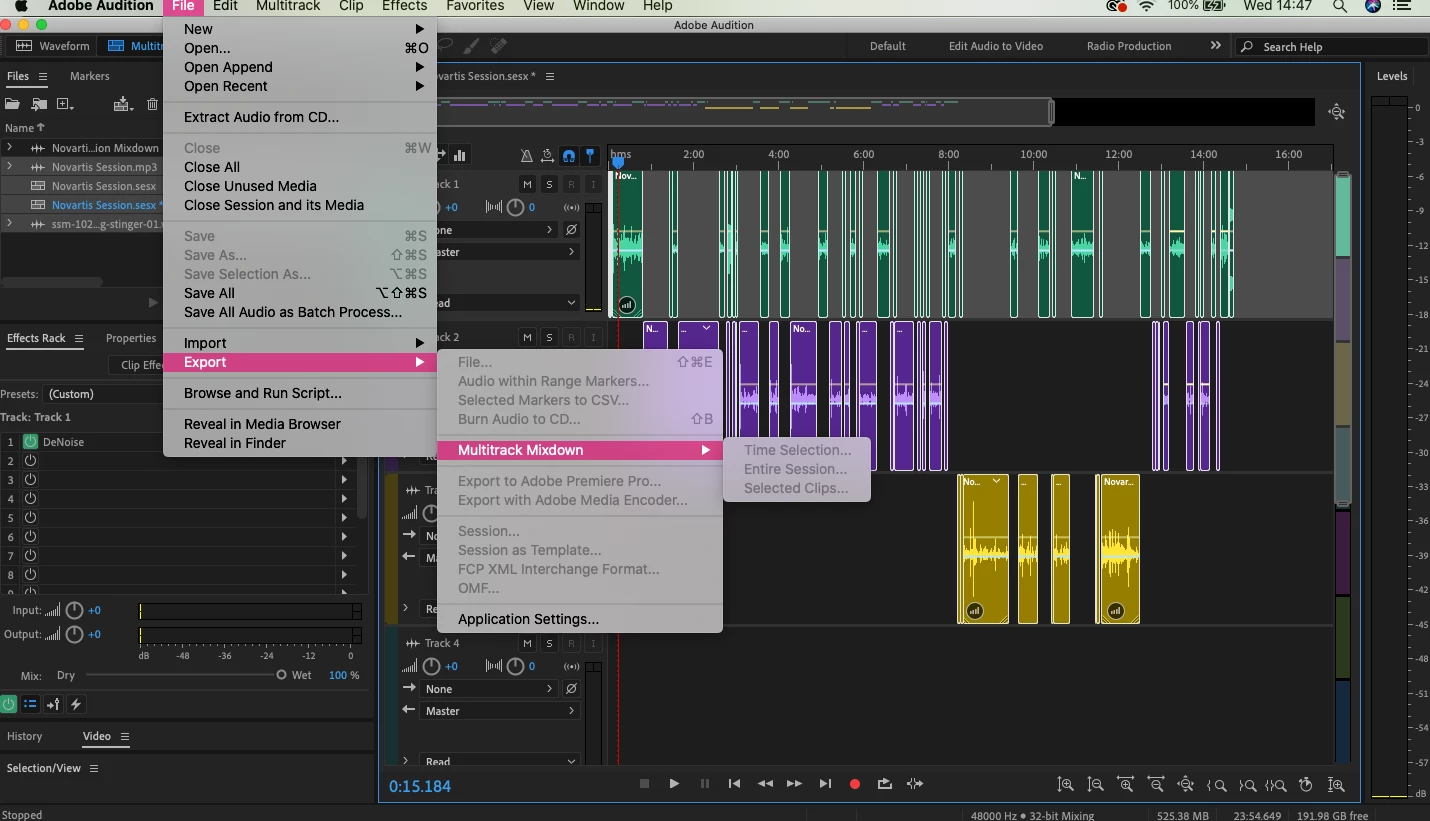

Thank you for your reply. All the options under Multitrack Mixdown are greyed (entire session, selected clips, etc) while I'm in multitrack view, not waveform. I see all the multiple tracks in front of me. Could it be that I don't have a proper sound card?
It has nothing whatsoever to do with soundcards or anything hardware at all - a mixdown is purely a software thing; it creates a file. The other thing that often catches people out is that all of your individual tracks have to be routed to the Master section before anything will happen. The only exception to this is if a track is routed to a bus. If you do this, the bus has to be routed to the Master output to make that track audible. If you've fulfilled all of those conditions, the option should be there. If it isn't, then try creating a new test mix and see if that works. If that does, then you have a faulty session file (unfortunately not unknown).

Hi, thank you. I'm aware that an sesx file is just project file, and not an actually exported audio file. I want to save my session in order to be able to close audition and return to it if needed. Apologies if my wording was confusing - but I know the difference between an audition sesx. session file and an exported audio file. As you can see from the screenshot, I don't even have the option to save or export - which is the main question I have - why?
Appreciate your feedback!
