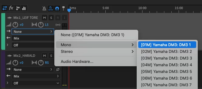

Hi experts!
Trying to set up a multitrack session template for a studio podcast recording with four mics.
- ...who are connected to mac through a Yamaha DM3 mixer. Assigned mic 1 to input track 1, mic 2 to track 2 etc.
- Exported "Session as Template"
- Next day: Creates a new multitrack session with this template (Made sure mixer already was connected and chosen as hardware input in Audition.)
- Every track has the correct names and effects - but all track inputs say "None", even if the tracks can "see" the right inputs (attached screenshot) So I have to reassign each track input manually again.
Which is a problem, especially since this template is made to make recording as quick and easy as possible for several other persons without the skills or time to deal with configuration.
Any advices?

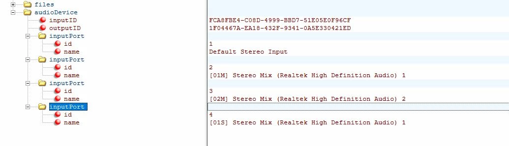

This is really SuiteSpot's area of expertise, but anyway, I had a look at a typical .sesx file, and at the end of it is a section about the audio device:
And it certainly shows all the information that I'd expect to see for a sound device directly connected, in this case, to this laptop. On the face of it, it should show your mixer as the Device, and typically select the correct input source for it. Can you post the session file that your template creates so we can have a look at it?

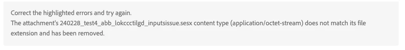

Rune Vandvik
Feb 28, 2024 12:00 PM UTC
Thanks, Steve! That would be great! Just give me a minute - now got a problem with posting files here. Not my day...
