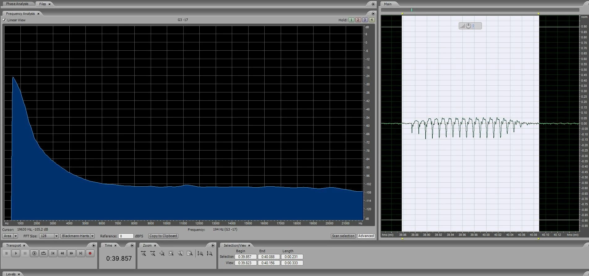

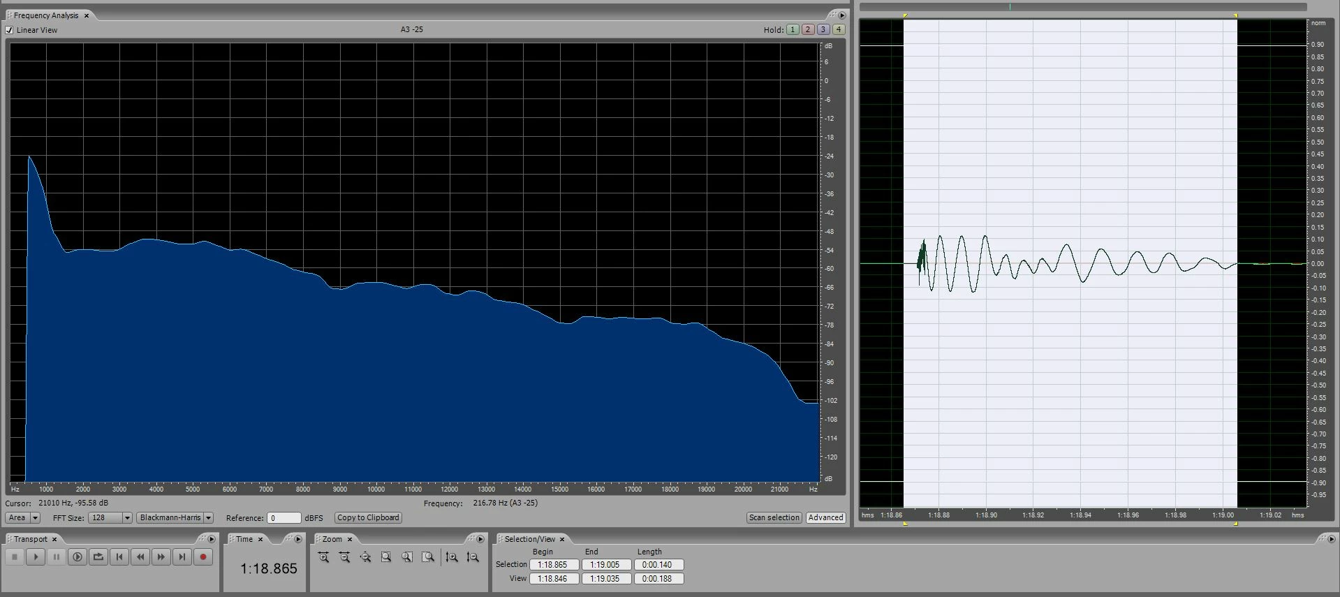

Jul 30, 2018 6:45 PM UTC
For the purposes of "mirror eq" - I have never done this (and wouldn´t be the only one!) but I think it is essential to know how to do it. We can see very clearly here the transients of the bass drum and synth bass guitar part - these two voices being the most typical of transients most people would like to see not fighting in the mix. The next question is what to do to effectively target and trim the areas of conflict and to boost by up to 3 dB on one side and to do the very opposite on the other waveform - the mirror image.which will allow a space for each and a total of 6 dB of spread in the mix. Can someone explain please a step by step analysis of these two depictions and then to give a step by step instruction on how to achieve the desired mirror eq? ThaNks in advance!
