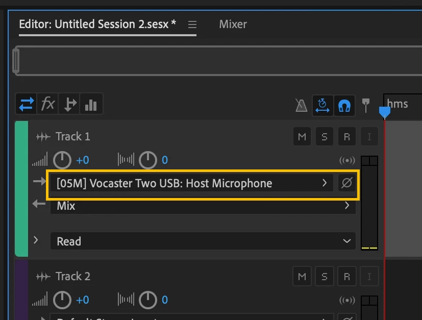

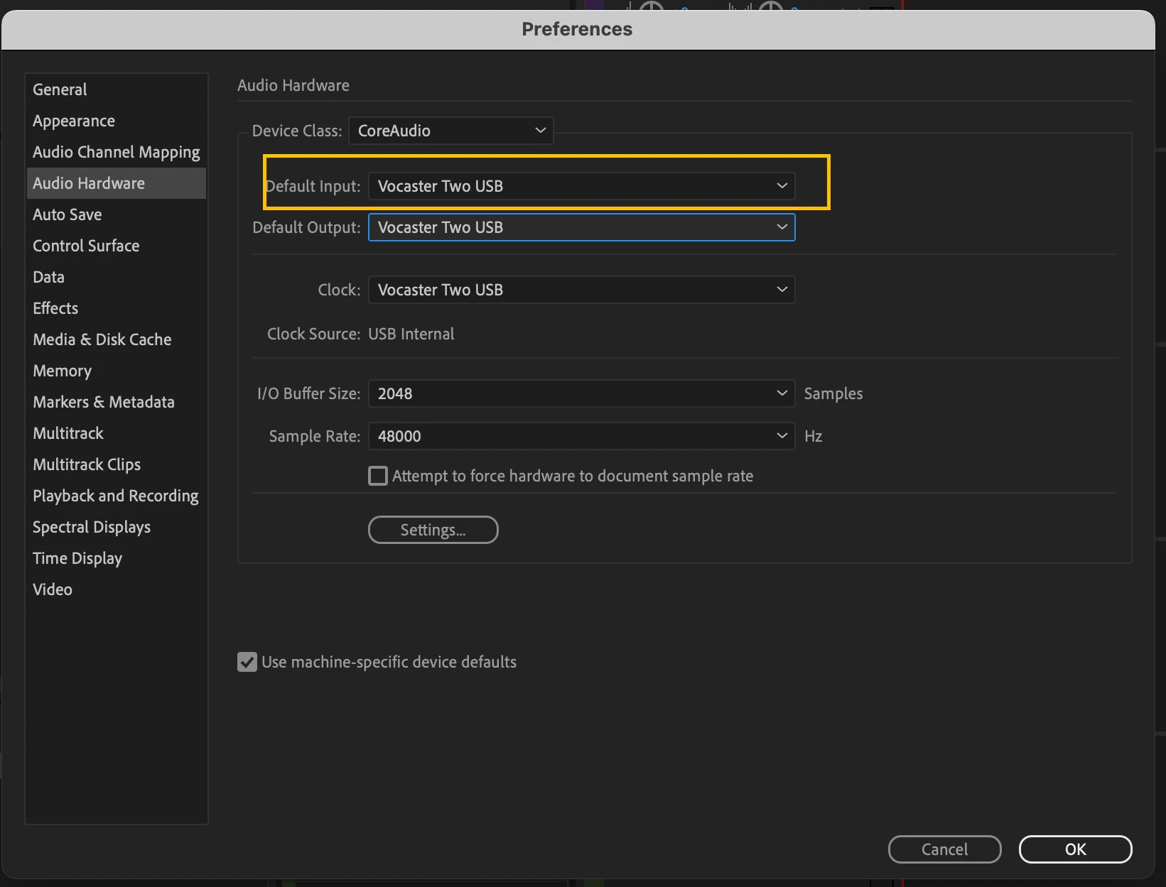

    Rag and Bone
    May 19, 2026 4:45 PM UTC
    Well, if it works in Garageband, it’s not an issue with the physical connection. What input have you selected in Audition’s Audio Hardware settings, and what input have you selected for the track you are recording to?
