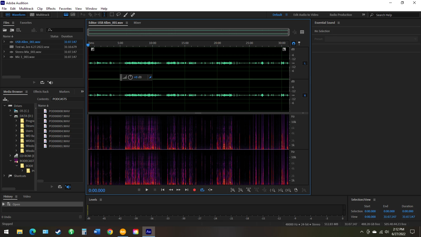

June 27, 2022
Here is a screenshot of the waveform visuals - it happens exactly at 25 minutes (in two separate recordings I made, one this morning and one last night) and I don't see anything unusual.  Am I looking at the wrong thing?
