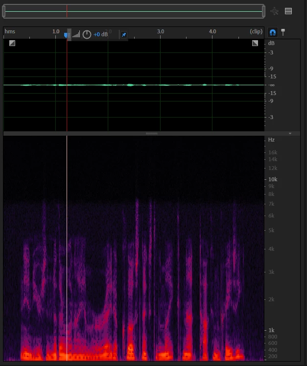

I'm just getting set up in Audition. I can record and the waveform shows very little except when I play it back it is very loud. I am opening up a new file, using the defaults, and am curious as to what I'm doing wrong. If I increase the system microphone volume enough to see the waveform then I get terrible distortion and clipping (yet the waveformn doesn't seem to show clipping). My setup is fairly basic, a Rode mic coupled to a soundblaster input card. I also run through Krisp but I have the same issue if I am using Krisp or not. I don't have any dedicated audio input setup (yet).
If I can back away from the mic a bit I can get pretty decent sound but I still get virtually no waveform as below.
What am I missing here that is making this sound so ugly?

What you are missing is that your replay volume is probably set to maximum, and it should be way, way lower. The record level you got in the second post is more like it, but you should be about 9" from the mic and getting that, not 18". There's nothing wrong with the way you're recording - just the way you are listening to it!
There's nothing wrong with the Rode mic, but Soundblaster cards are a different ballgame, and we've never recommended them. Their software could more accurately be called bloatware, and they lie about their specifications - to the extent that a few years ago there was a class action taken against them.

I'll add a bit more info here. My recording volume in Device properties was set to about 40%. At that level I had zero waveform. If I crank it up to 100% I get a waveform but have to stay back from the mic about 18 inches otherwise I pick up the distortion. I'm seeing most people with the mic almost in there mouth, yet I have to keep my distance. I feel like I'm missing something here.
Is this just the type of mic I'm using?
