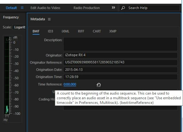

This works pretty well but I don’t see any way of displaying, or navigating with, the wav source timecode (which matches my sequence timecode and thus my notes). It’s not an insurmountable problem, but if there is a solution I’d be grateful to hear it.

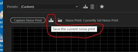

In addition - is there a way of ’storing’ noise prints for removal? (This week I’d have liked to sample a few of my room tones and stored them - then selectively applied them to different sections)
    I'm afraid that with audio, unless it's burned to a separate track as SMPTE, there's no concept of 'time code' at all. Programme duration is measured from the start of the audio, and the BWF format lets you offset this, so that clips can be placed according to their timestamps. You can alter these in Metadata if you need to:
    Saving noise prints isn't a problem:

    So the only way to have any reference to your timecode position is to insert the audio file into the Multitrack view using the BWF reference to place the clip at the correct place on the Timeline. You can also set an offset into your Audition session Start Time so that the clip isn't miles away up the timeline. But this doesn't help at all if you are viewing the audio file in the Waveform view.
    Perhaps we need a feature request to be able to offset the start time in the Waveform view which could be quite useful on this sort of occasion.
    All you'd need would be the option to use the BWF offset time reference as the displayed time, rather than starting at zero.
