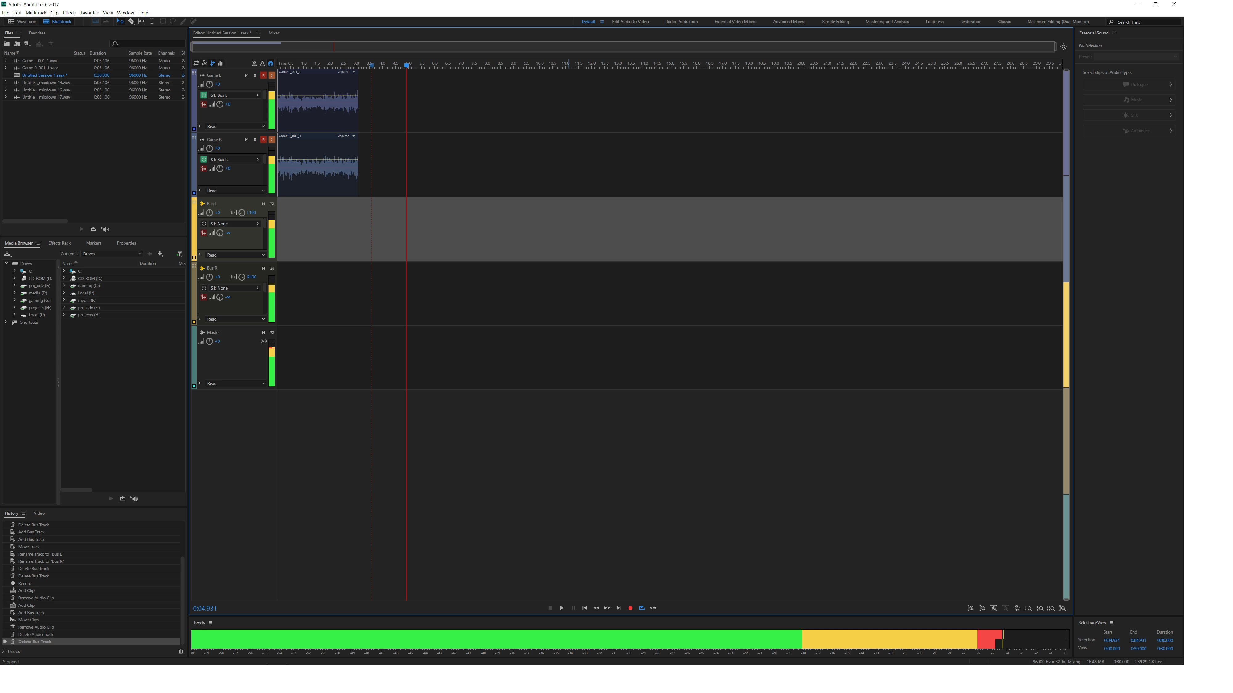

For the record, I never touched the busses or sends on any of the tracks. This is how they look like:
