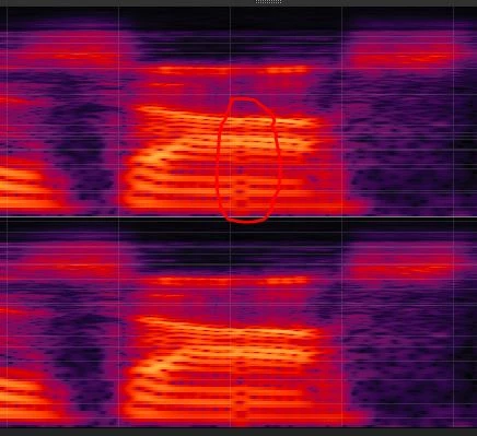

Need to see the original file, as well, to make a comparison. I can clearly see the blip on 'disaster' and it looks as though there's some sort of frequency-based error at the blip point (I've put a ring around it on one channel):

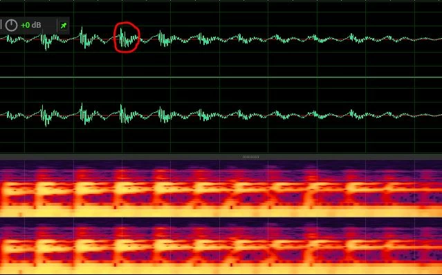

I can honestly say that I've never seen Audition do anything like that before, and although I suppose there's a first time for everything... that said, there are other disturbing things about your recordings that may well be significant, one of them being the rather grating distortion that I can actually show you pictures of. The first one is the waveform from a single word from one of your files, and the second is a picture of what a similar length word from a completely different file looks like when it's not distorted (I've ringed one bit of the distortion in your file so you can see what I'm looking at, but it's present everywhere):
And this is why I'd like to see the original untouched files.
