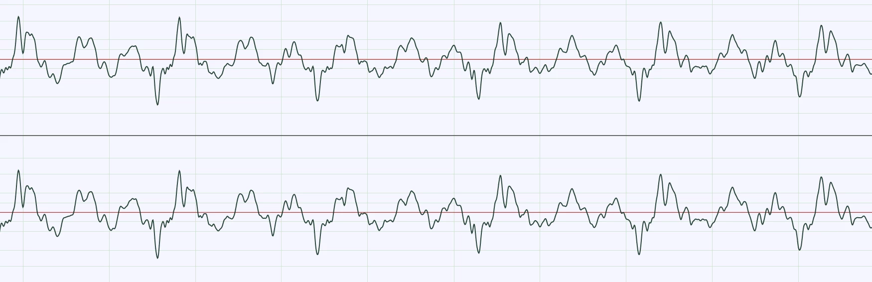

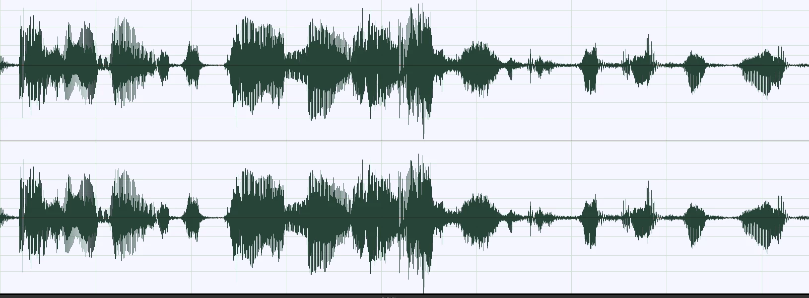

For a couple of weeks now I've experienced a bit of "low buzz" on playback of vocal recordings. It doesn't appear to be distortion or clipping from overmodulation (my level never appears to peak or play into the red area of the recorded level meter). I have mp3s recorded of the distortion if anyone wants to diagnose them from the sound.
On the second zoomed in pic below, you can see odd, jagged lines in the vocal tracking. Any idea what's going on? Thanks in advance, I'll keep an eye out for you.

Hard to say, but it sounds very much like a fault in the mic itself - or possibly it's overdriving the preamp (turn the gain down a bit and see if that helps). Do you have another mic you can try, for a start? That would start to eliminate some of the possibilities. Have to say though that this really does sound a bit 'mechanical', if you see what I mean...
