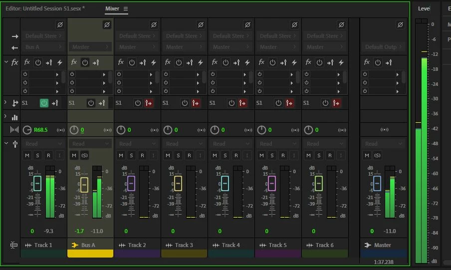

This is a mono on a stereo track, panned, and sent to a bus, and the bus sent to the master. The only panning in the shot is on the mono track, and it's passed through. If you pan the track the same amount in the opposite direction using the bus pan, then it puts it back to mono again - the level pass-through appears to be completely correct.

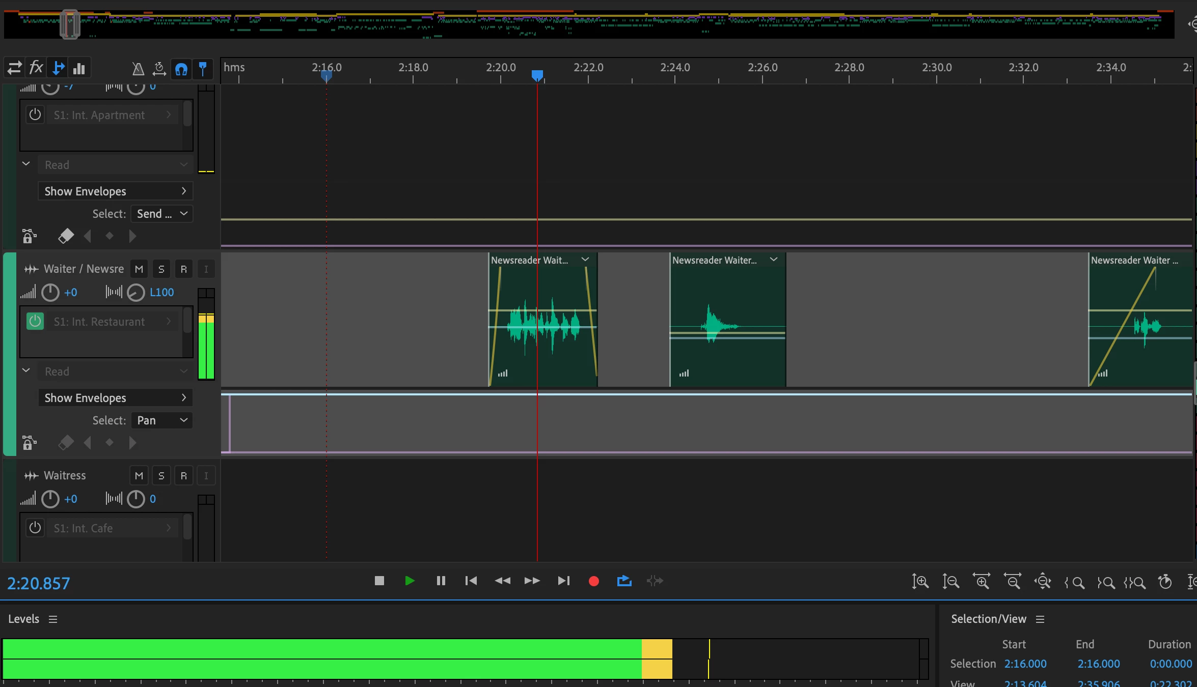

Here's my multitrack - as you can see I've panned the track all the way to the left, the clip is in the centre. All it does is go to a bus which is also set to centre. Very confusing!

The multitrack doesn't tell me very much - a view of the mixer would probably reveal rather more...
The one condition that would cause this to happen - definitely - is for either the original track, or the bus track, to have the 'sum to mono' button active.
