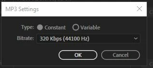

Can you confirm that if, as a last step in exporting, you reset the MP3 settings to look like this:
That the export happens and is reported in the properties, as mentioned above, as 192kbps?
