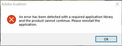

My situation is that AA3 would not load and I got the following message:
I have reinstalled AA numerous times with no change.
I have the same program installed on my laptop and do not have this issue. Is this a computer/Windows 10 issue? Can anyone help?
