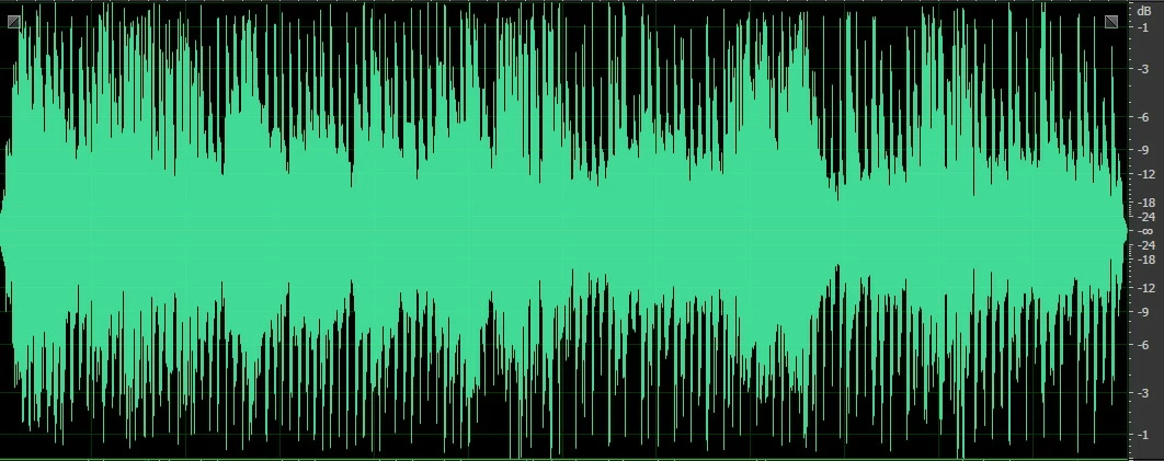

Wave file A

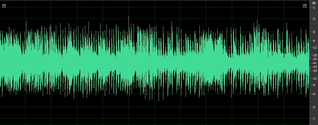

Wave file B
These 60 second wave files are exactly the same tune.  I am trying to get as close as possible wave B to match wave A sonically.  Compared to A, the bass in B is way down.  The midrange sounds flat as was well as the upper midrange like cymbals etcetera.
First I normalised B to 0dB, then tried the Dynamic Possessing - Stereo Rock Mix.  Removed this effect and tried the Multiband Compressor - Pop Master.  Removed this effect and tried the Parametric Equaliser, boosting bass, midrange and higher frequencies.  None of what I tried gave me satisfactory results in trying to match file B to A.
When normalising, what dB should I first use if I then use other effects and boost bass and upper midrange etcetera up 6 or 9 dB?
Are Amplitude and Compression best to use for this or Filters and EQ?

    If the midrange sounds 'flat', that's almost certainly because somebody's already compressed it, so you'd need to undo this. But you can't, as you have no idea what they did it with, or what they used. To get the frequency response correct, you need something that has EQ matching in it - like Ozone or Fabfilter, perhaps. But I wouldn't use either of those to do this specifically - I'd use Har-Bal, as it's sort-of designed to do this job, which is otherwise pretty difficult to achieve without some serious analysis tools - which it has. You can read a review of it here:

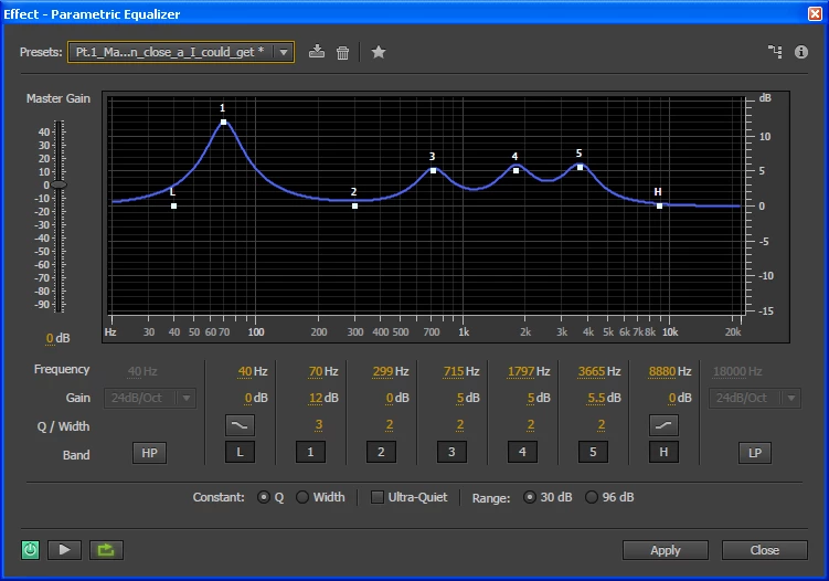

    Before you posted, I tried more with the Parametric EQ.  These settings for B came close to A and it sounds not too bad:

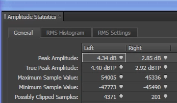

    What do you think of the Amplitude Statistics?  I can't hear distortion or clipping.  After the EQ settings, should I use the Hard Limiter or the Single-band Compressor?  Which is the better to keep as much dynamic range as possible and what settings please?

    Audition's worked out the amplitude statistics based on a Floating Point estimate of where the peak amplitude would be if you converted to a final integer-based file, and it says that you'll have rather a lot of clipped samples on the LHS. These are likely to be caused by the largest boost you've applied, which is the +12dB @70Hz. This won't be anything like as noticeable as clipping at a higher frequency would be, but I'd still be inclined to lose it by normalizing the results back to about -1dB (assuming that you're happy with the channel balance, that is).
