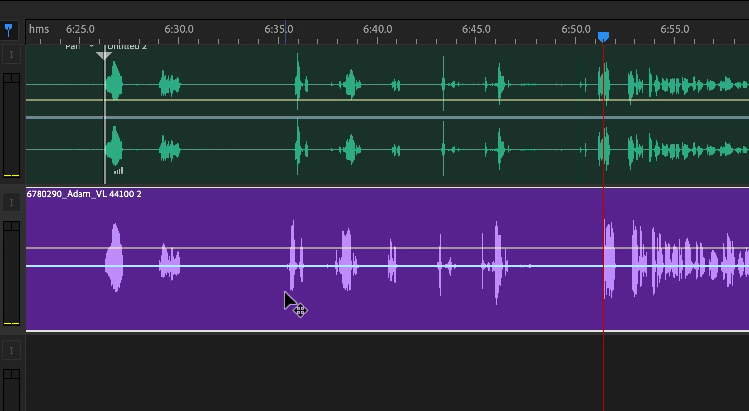

Recording a conversation — my side locally into Audition (on Yeti mic), my partner's locally through Zoom.
I use my track of the Zoom recording only to find where to line up and sync with my local recording, and then use the local track for the actual mix.
Crazy part is — and this didn't use to happen — the track is lined up in one place and then becomes unaligned immediately, sometimes early, sometimes late.  It's exactly the same length but it's as if the pauses are stretched in certain places, or the conversation is stretched half a percent, or... I have no idea.  It's making me question the nature of time.
Image attached shows how the (local) track is synced to start, early at the cursor, late at the playhead.  What's going on???

With an error that great, you should check that the Zoom input and your Yeti mic are running at the same sample rate. Just a simple sync slip shouldn't be anything like that large, but Audition can only run a session at one rate, and if one of the signals is getting somehow 'reinterpreted', it might account for that size of error...
Aug 9, 2021 7:11 PM UTC
Those are good calls — thanks for thinking about it.  Zoom goes at 33k and Audition defaults to 44.1, but that's never been an issue before to convert into the Audition session.  (And yeah, it seems nuts that it would make that big a change, and the kind of change that varies over time.)
Like... could the wifi signal affect the lags on the locally recorded Zoom input?  Makes no sense. Even trying to match up the local tracks (one from each side of the conversation, local Zoom + local Yeti) can't be synced normally.  Like, without even being mediated by wifi/compression, time is already getting bent...
