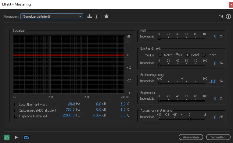

    I found out that if I combine the two settings (first mastering effect, then center extraction) I can get a really clear extraction of the center channel. When I use the center extraction on its own, either the result is ok or there are too many sounds left from the side channels.
    But if I use the mastering setting as shown in the screenshot, the extraction result sounds crystal clear and the only sound left from the side channels are its high frequencies which have been placed in the center channel due to the mastering effect.

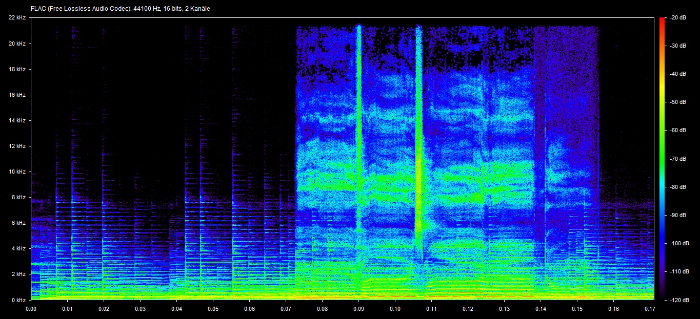

    This is a snippet from a song (only vocals and piano) to show you what I mean. This screenshot shows only the snippet without any effects or edits:

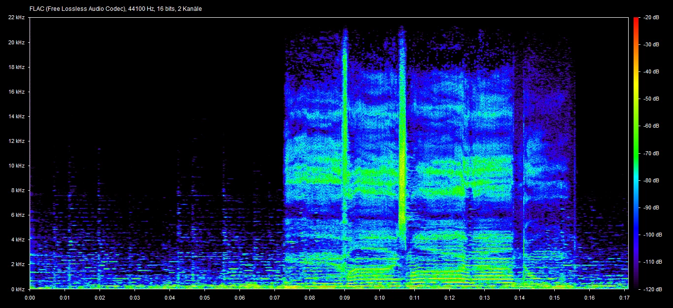

    The next one is the same snippet where I used the Center Extraction effect:
    I used for the next screenshot this setting:

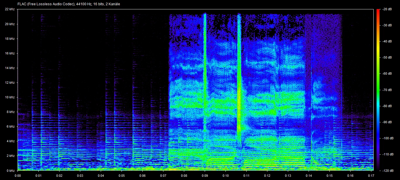

    I used on the unedited snippet this mastering settting twice and then I used the same Center Extraction settings as I did for the second screenshot:
    When I use the mastering AND center extraction I get a clear result for the center channel, in this case the vocals (they start around 0:07 on the screenshots and end between 0:15 and 0:16).
    But as you can see in the last screenshot the piano from the side channels are suddenly in the center channel due to the mastering effect.

    I'm afraid that I can't tell anything at all from any of those screenshots, as they're all mono spectral displays, and we're talking about an effect that manifests itself in a stereo field.
    The stereo width control converts the stereo signal to a sum and difference form, and simply reduces the difference level to make the sound-field narrower, or increases it to make it wider. If you reduce it to zero, then all that remains is the sum - which is both channels added together. It is inevitable that if you do this, frequencies that are present in either channel will be summed together in the centre. The only way they will not be present is if the signals are in completely the opposite phase in the other channel, and cancelled out. In a normal stereo recording, this simply doesn't happen, so what you've got is inevitable.
    The center channel extractor works differently though. It's a FFT process that looks only at the sound occurring in one spatial position, and either boosts or reduces it just at that point. As such, it disregards anything to do with the stereo field at all - which is why, when you use it as a vocal extractor on a vocal with stereo reverb, the reverb remains afterwards as a sort of 'ghost' vocal that you'll never get rid of. Also it will get rid of anything else in that spatial position, regardless of what it is - so quite often it will make a material difference to the bass as well.
    Any attempt at all to combine the two effects is likely to result at best in an unpredictable result, and there are no settings that will get around that, as the effects work in significantly different ways.
