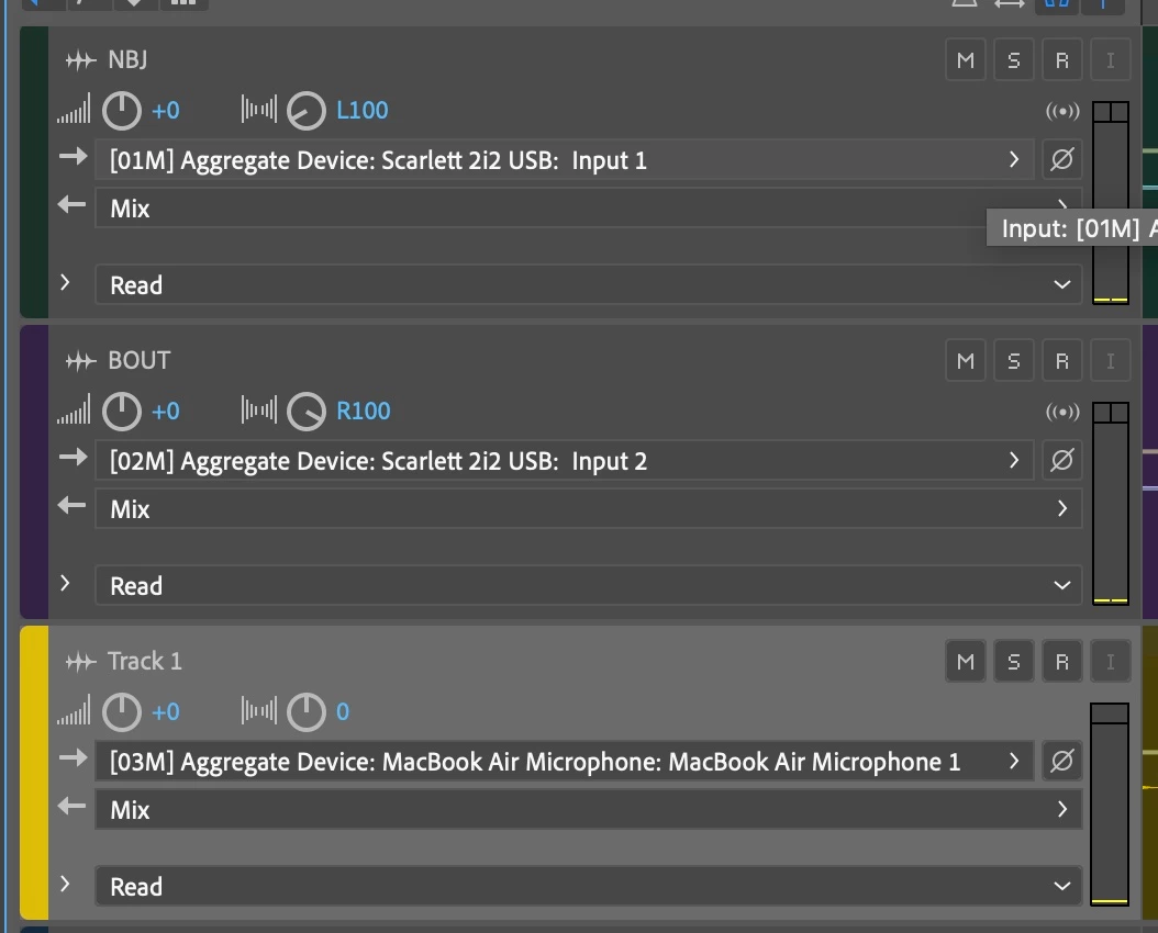

I should add that I did successfully test this using my Mac's microphone as a third source. AA recognizes the aggregate device and shows three inputs. (See screen shot.) I just want to verify that it will work with another Scarlett connected through the second USB port. Don't see why it wouldn't if CoreAudio "accepts" the existence of that virtual device, but wanted to see if anyone had actually pulled it off IRL. Thanks - Edward
