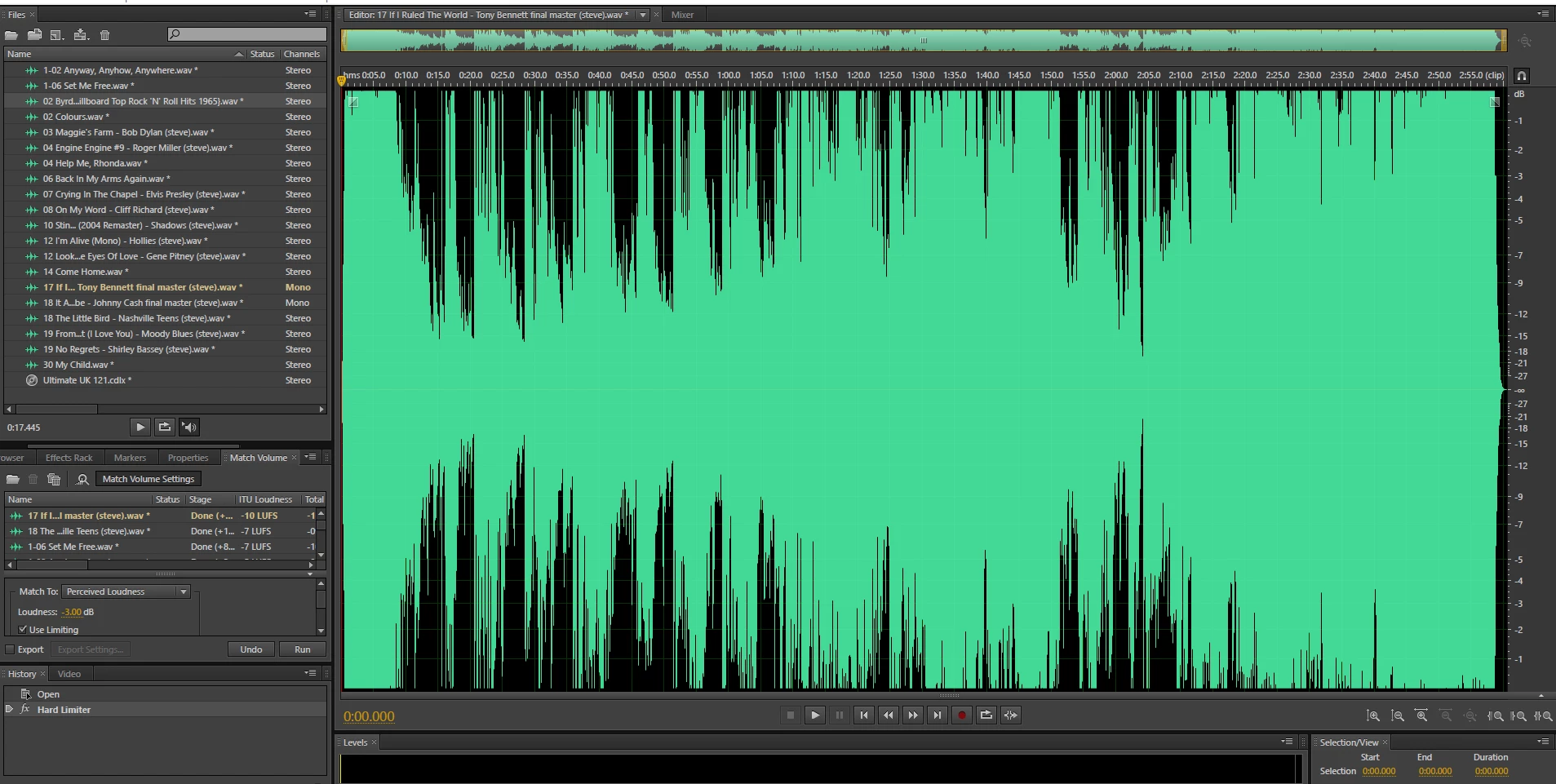

That doesn't look good. Try using the "ITU-R BS.1770-3" option in  Match Loudness, and set a max true peak level of -1.
The target level you set is a a trade off: higher values give more loudness at the expense of dynamics.  As a starting point, Spotify use -14.

Aug 24, 2025 1:05 PM UTC
Here is a screen shot showing the result of the -3db (perceived loudness). Is it acceptable?
