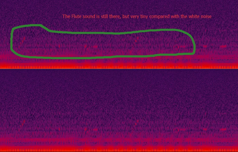

Very important music recording failed
Hello experts!
I am a university student. I helped my classmates in music composition class record their final project. However, one of the recording failed for some unknown reason (maybe because I changed the sample rate from 44100 to 48000 before recording). Now, I can barely hear the instruments but they are overlayed by very loud white noise.
This recording is very important because we invited a flute player who was a very busy professor, and the performance was perfect. Is there any chance I can recover the recording from the broken recording file?
Thank you!

The two things I can now tell you definitively about this are that it isn't an Audition fault, and also that there is no chance of recovering a usable recording from it, I'm afraid. Even if you boost the level, and apply loads of NR to it, you only end up with faint music in the background, and still plenty of noise.
This actually sounds like a hardware fault, before digitising.

Very unlikely I'm afraid. Also a lot of the noise from your picture could be hum or buzz from a poor connection. You would have to post a sample somewhere like Dropbox for us to listen to to make a full judgement but I wouldn't be very hopeful about the outcome.

I'm not holding out much hope, but I notice that you haven't told us exactly how you made the recording. Changing the sample rate wouldn't in itself account for what has happened, so this is a little strange; Audition is remarkably good at recording what it's sent, so I'm guessing that the fault occurred before it got into the software. So I have a couple of questions: 1) Was this recorded in Waveform or Multitrack view? The differences are significant. 2) Can you give us a breakdown of the complete recording chain? As ryclark says, a dropbox sample (original file, not an MP3) would be useful too.
But from looking at the spectral results, I have to say that if this is all that's on your file, you don't really stand a chance, I'm afraid.
