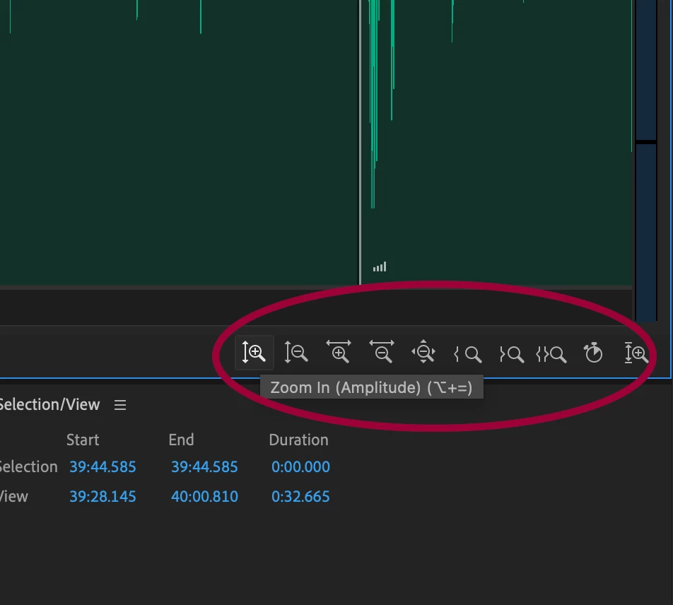

Rag and Bone
Sep 22, 2024 8:17 PM UTC
Do you just mean the track height? The view controls are in the bottom right.
If you hover you'll be shown the key commands.
