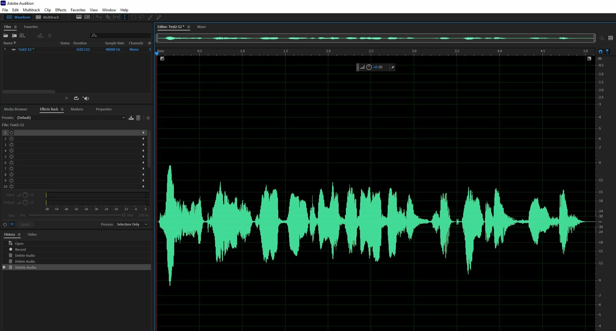

Audition records dry - always has done, always will - but if you have any effects on the track at all as you record, then you'll hear them on the monitoring or when you play back the track without removing them from the effects chain (the dry recording will be played back through the same effects). Whatever this is, it won't be an Audition issue otherwise we'd all be experiencing it! Can we see a screen-grab of the Audition session you're recording into? Especially the track controls...
The other thing of course is the monitoring itself. How are you doing this?

Hi Steve! Thanks for the reply. I've attached a screenshotof the Audition environment after recording. But I have to correct something that I wasn't aware of earlier. As a test I exported audio from both systems, and after they are exported they DO sound the same. It's only while the audio is IN PT that it sounds "better", for lack of a better term. So once it's exported it goes back to sounding more echo-ie. I was only listening with the audio in the two systems. So I think I would have to work on improving the signal going into Audition from the Mackie??? Could it be as simple as just an EQ issue coming off the Mackie?
