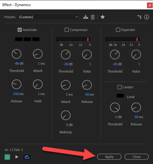

Dec 15, 2023 6:36 PM UTC
I've found that I forget to click the "Apply" button to effects before I save the file. Hence, though I can hear the effect in the waveform preview, it's not reflected in the file being utilized in the multitrack because it was never officially applied to the saved file.
