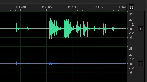

Hi, I'm working an old project in Audition CS6 with some complex routing that allows me to render either 2.0 or 5.1 output and I'm seeing a weird signal anomaly that I can't explain. I'm hoping someone here can shed some light. Basically, I built all tracks in the session to OUTPUT (or Send) to a 5.1 buss chain to the ultimate MASTER 5.1 track. To build the 2.0 Mix, I used Sends on each track to a 2.0 signal chain to ultimately, again, the 5.1 MASTER track. (when I bounce the 2.0 mix, I get a 5.1 file with information only in the L/R channels, which I then downcovert to a true Stereo 2-channel file, adding back in the 8.15 dB lost in the conversion from 5.1 to 2.0).
Here's my issue: I have a mono clip on a mono track that is OUTPUT to a 5.1 buss chain (which is muted). I have a Send on that same mono track to a stereo track that is ultimately routed to the MASTER 5.1 track. I have that Send panned 100% Left. When I play the clip, the meters from the track, all the busses, and the 5.1 MASTER show information ONLY in the Left channel (even with meters set to 120 dB range). That's what I would expect.

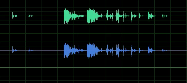

Now, here's the interesting part. When I mixdown the session where ONLY that one track is Soloed, I get a 5.1 file that has information in BOTH the L and R channels. The Left channel is very Predominate, as you would expect, but there is some kind of visible (and audible) "echo" on the R channel at a much lower volume. Since the Meters do not show this on playback, and I can't hear it on playback, WHY is the mixdown putting signal in the Right channel? See attached image.

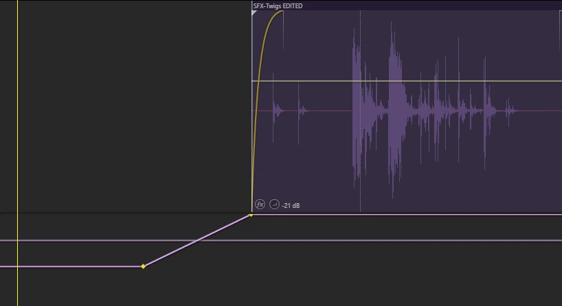

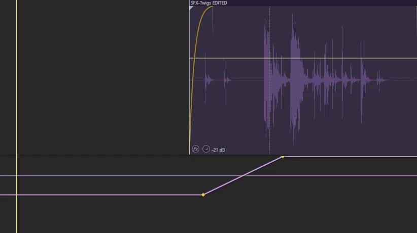

Image 0 shows the original automation (Send 5: Pan is highlighted) relative to the clip in question. The Capture image in the previous post is what resulted from a Mixdown Session to File. As noted, the Pan is clearly NOT at 100% L in that mix down waveform.

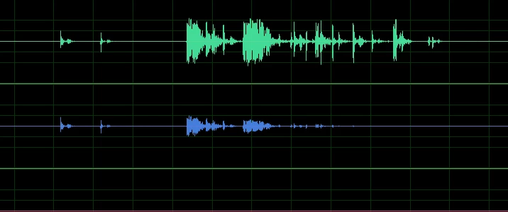

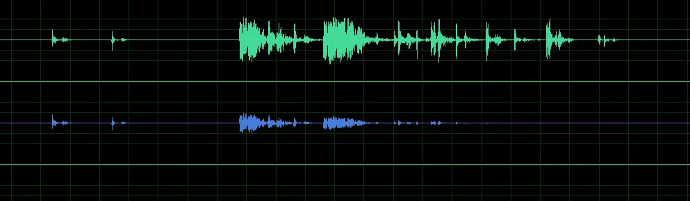

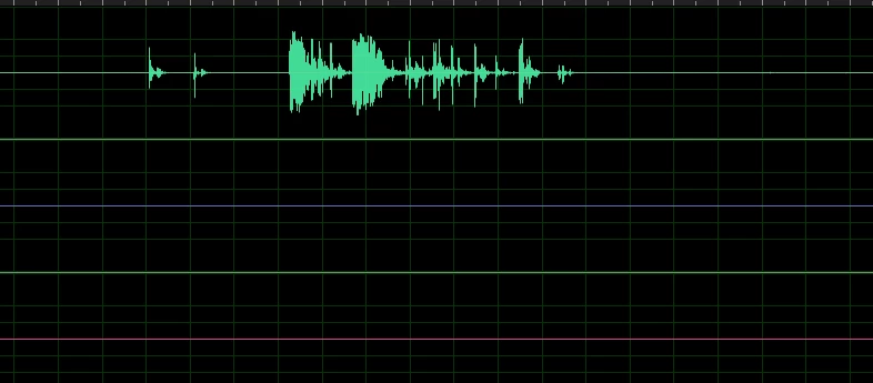

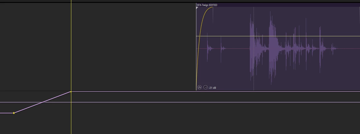

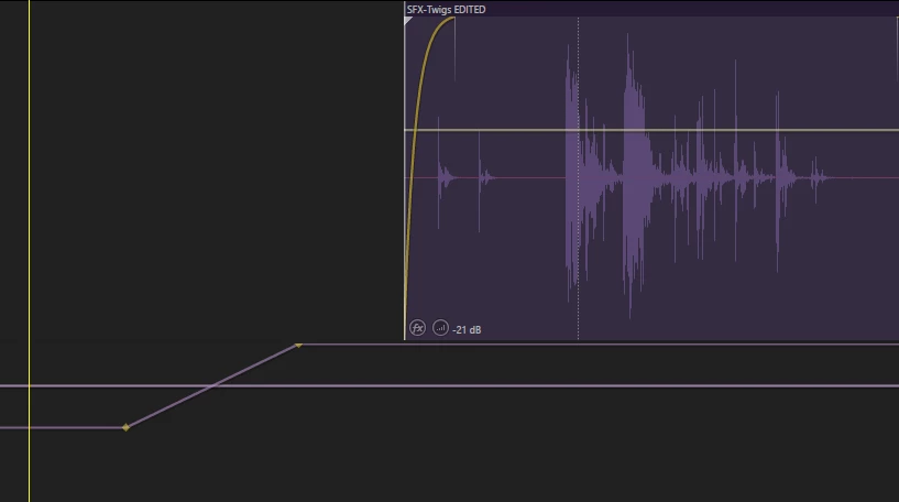

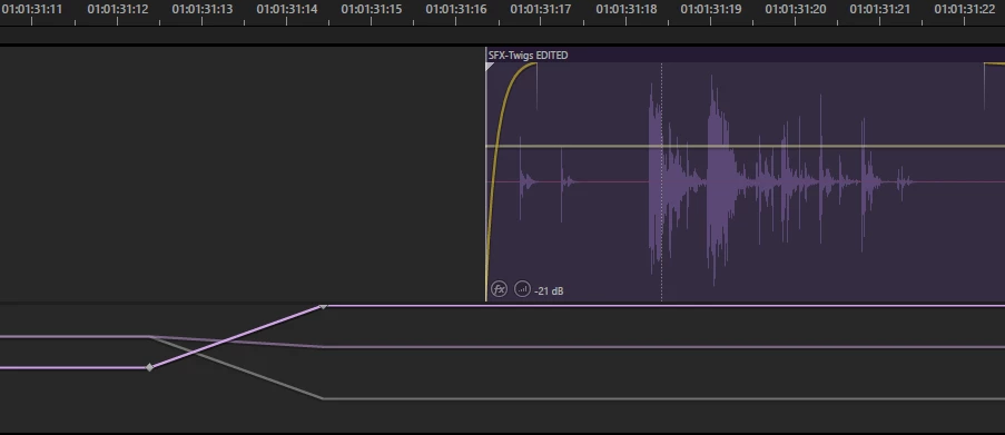

Before doing these final tests, I eliminated the other two automation lanes related to other signal flows just to ensure they were not the cause (they weren't). In image 1, you will see where I moved the 100% L point back in time the approximately 185 ms I determined would give the proper (left only) mixdown, shown in image 2 (the cursor is ~185 ms prior to clip start). In image 3, I slid the Pan ramp to the right in time (cursor remains in original position throughout) to somewhere in-between the 185 ms point and the clip, which gives the mixdown shown in image 4. I slid the Pan ramp even further in time as shown in image 5, which you would think would still be 100% L, but which gave the mixdown shown in image 6. When I slid the Pan ramp to the position shown in image 7, I finally got a mixdown that was a Center Pan (both channels equal), as shown in image 8.
I am unsure why any position of the final automation state within 185 ms of the clip does not truly represent what is being downmixed. As I said, when I play it back, I hear only signal in the Left channel, and that is what is shown on the meters, and what is shown when the track is Bounced to a new track. Only the Mix Down has the timing defect. Depending on the scale of the project, this could be huge, and completely unexpected since it differs from what is seen in the DAW when mixing.
